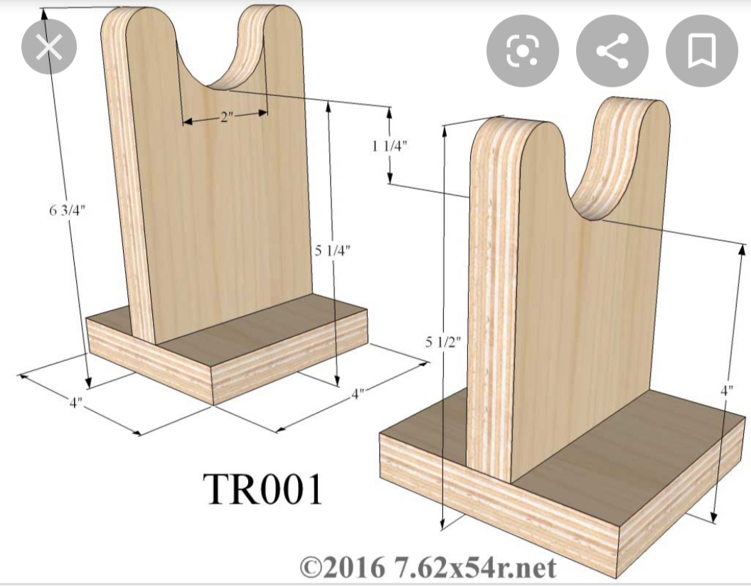

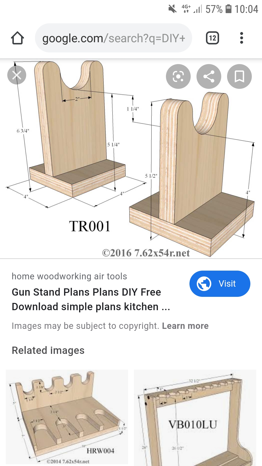

Hi Everyone,
Just wondering if anyone has any DIY plans for a Rifle cleaning cradle / rack / stand?
I'm getting some ply cut tomorrow and seems and it seems a 'no brainer' to get a few extra bits cut to screw together.
It'll be far easier if I had some plans to copy!
Thanks.
Keith

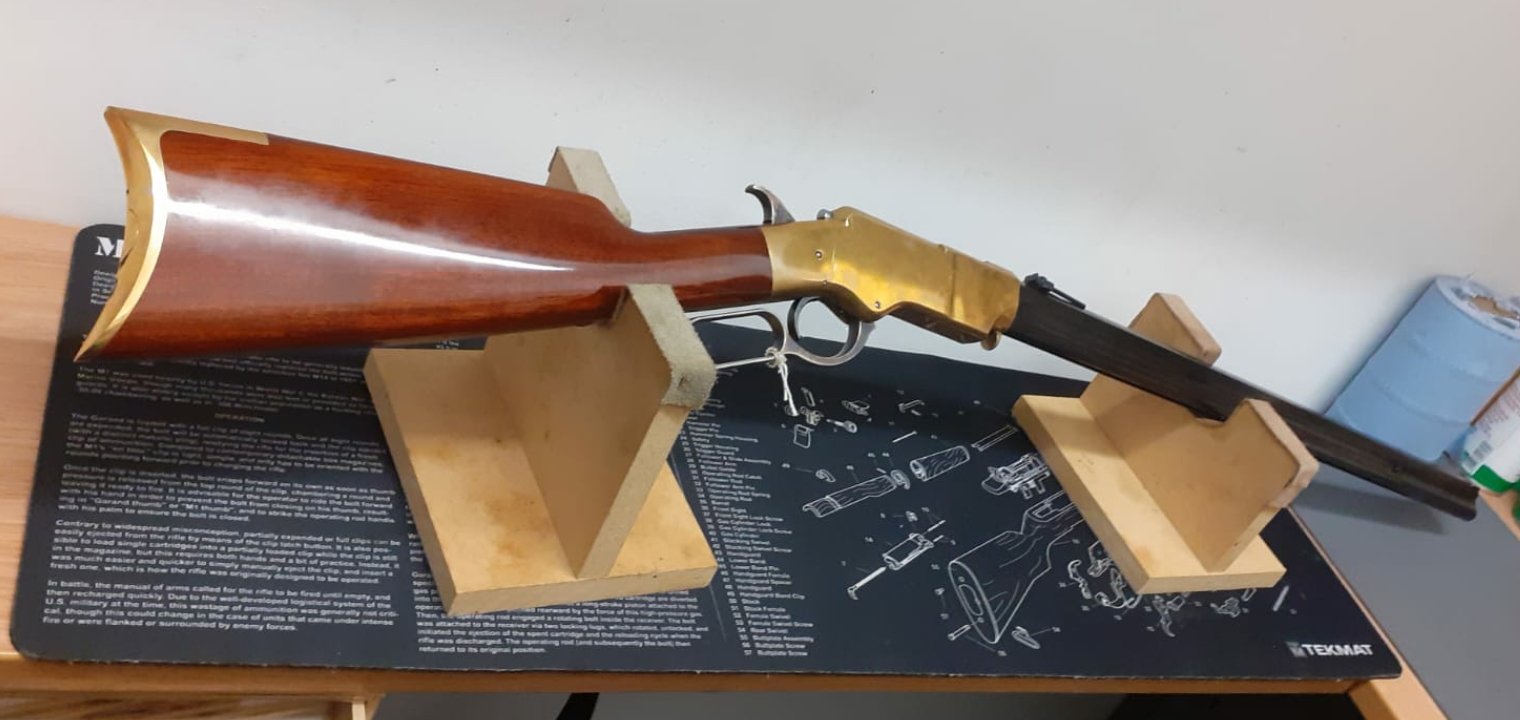

I made these years ago from some MDF that was lying around.
Works a treat.
Not the best,just simple like me. lol

Many thanks Vosie and way quicker and easier than I'd been thinking goodjob thankssign

Thanks 'MM',
Unfortunately no access to a 3D printer.
Going to knock up something similar to the above in timber this weekend :good:
