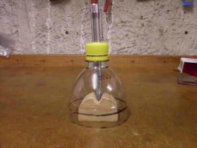

My no cost solution.

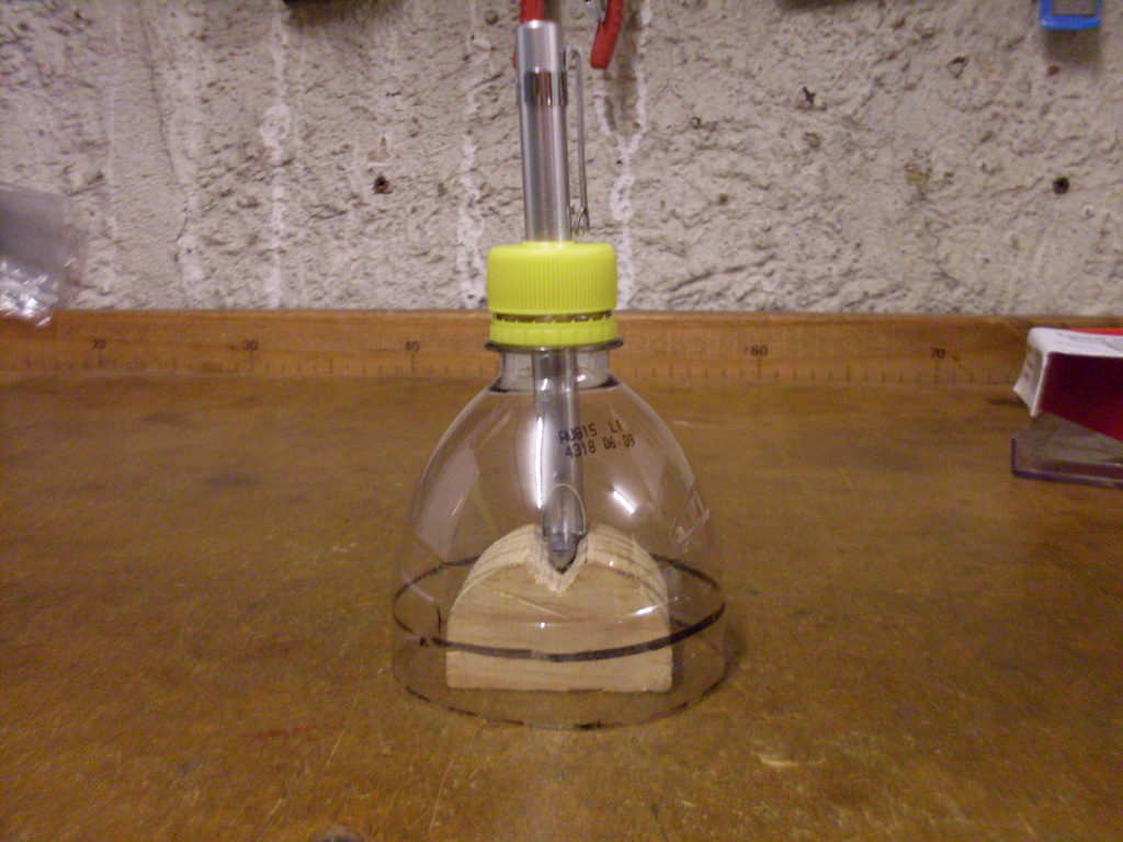

NICE IDEAukrifleman wrote: ↑Sun Jul 16, 2023 10:10 am SDC18768.JPG
I use a Lee hardness tester to check cast batches and it can be a PITA to align the 20X magnifier on the indent.
ukrifleman
