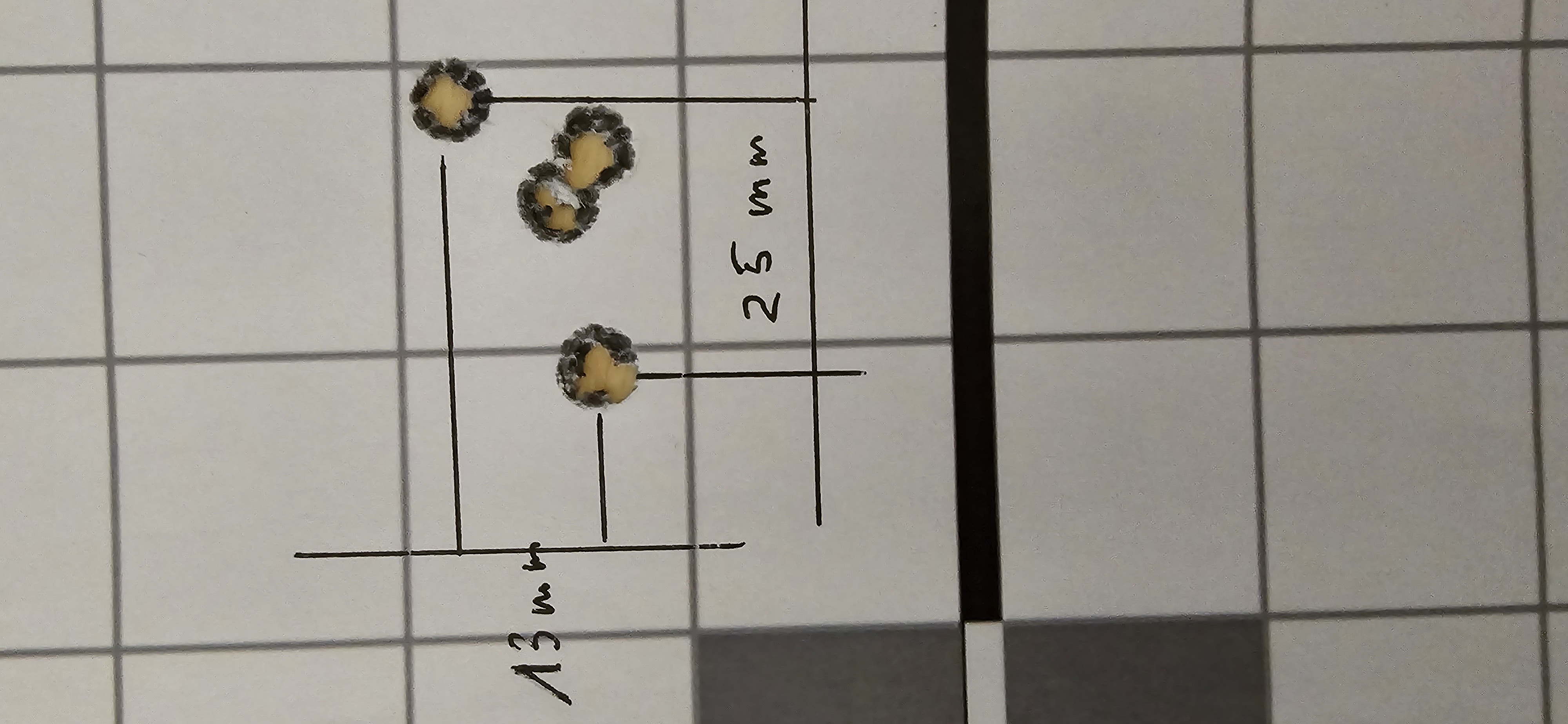

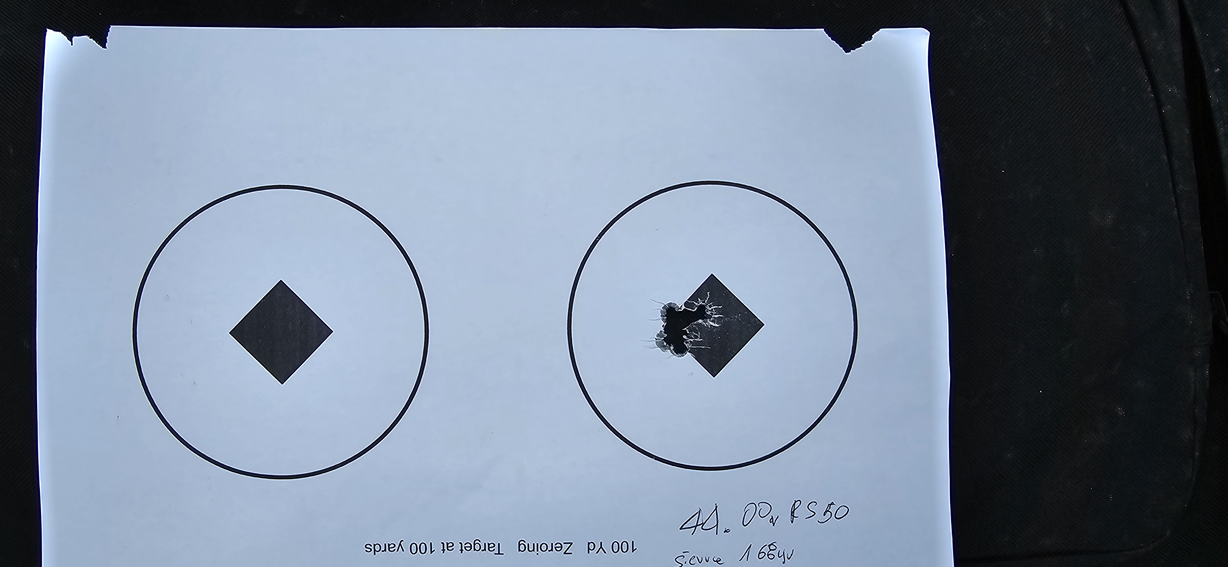

I know amount of powder is most important thing in reloading, that is why i was looking for advice about scales, I agree lee isn't most accurate one. But I've checked them yesterday with calibration weights 10g, 20g and 50g and they both showing the same results. Also previous loads couldn't be that bad, I managing to get this sort of group at 100 yards
and 300 yards
Anyway I think I'll give Gempro go and get some decent beam scaleWho is online
