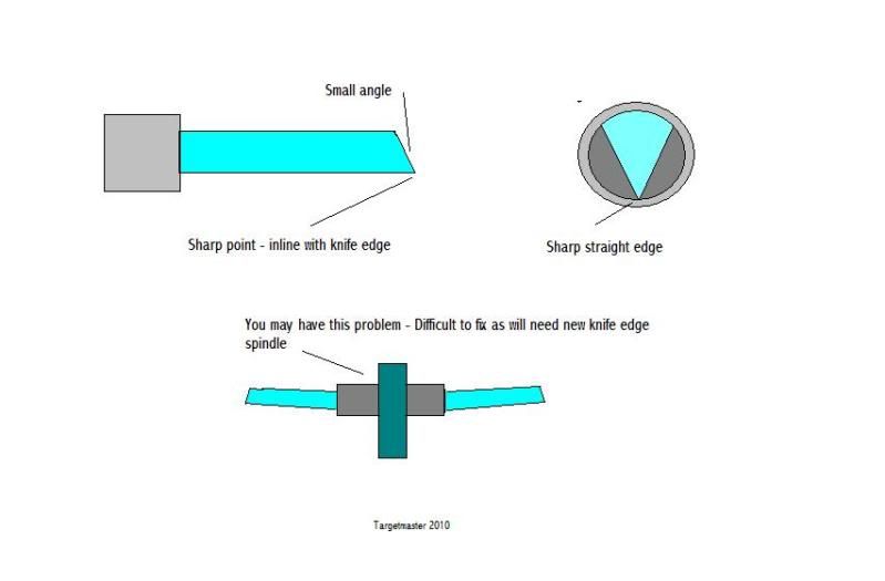

I think you have identified the problem, it's probably the knife edges but I would start by taking the bearing end plates off and removing the bearings. These need a good clean with some spirit based fluid to remove any trace of grease.
I always polish the outside of the bearing block with 1200 wet&dry then rub some boron nitride powder on them and also polish the bump they sit on, they must be free to wobble about. (they are made of agate and very hard) Then you need to polish the inside of the bearing end plate to remove any minute burrs where the knife edge pivot points touch.
Inspect the knife edge through a high power glass, there should be no dull edges or burrs and the pivot points should be sharp and inline with the knife edge. If the pivot points are in good condition it shouldn't really matter that they are touching the bearing end plates.
The damper not being centeral in the slot shouldn't be a problem as long as it's not making any contact.

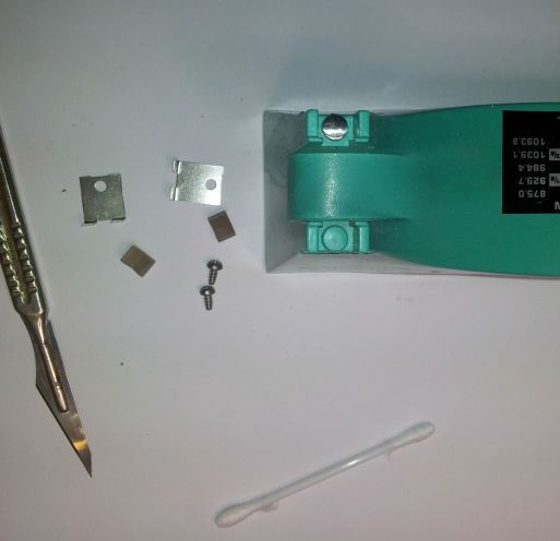

Here is a 505 scale I had a look at this week.

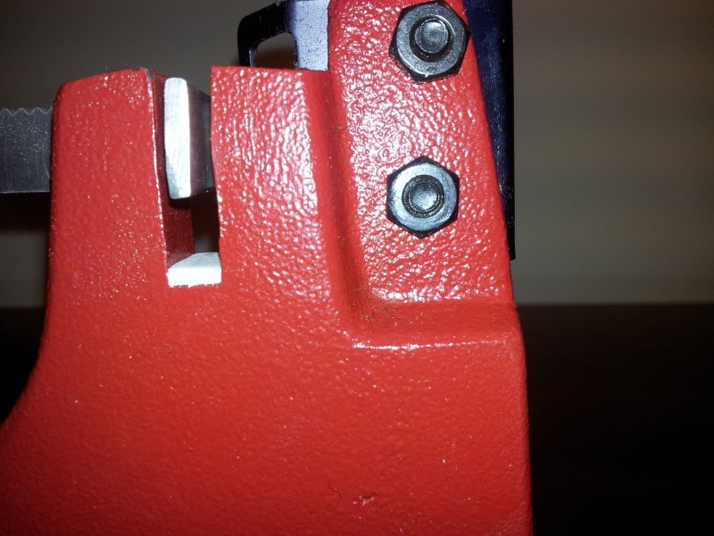

Ok - I've had a look at my Hornady/Pacific scales and I think I have found the problem.
What seems to happen is that if the tare is not set correctly so that the beam is more or less level when in the zero position the beam becomes top heavy and sits in the bottom position.
I have taken a couple photos but Photobucket is down at the moment so I can't upload them. I'll post them when I can.
An easy fix is to place a small strip of cardboard or felt about 2mm thick in the bottom of the damper slot to stop the beam dropping down quite so far and going over centre.
For best results with these scales the jacking screw needs to be well extended then the two locknuts adjusted to give a zero reading this will make the beam near level when zeroed.
Also you could loosen the bearing screws and turn them 90 degrees and use a fresh part of the bearing just incase there are any burrs on the bearing surface.

Here's the pics :-
