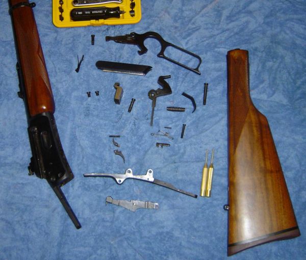

First step was to disassemble the rifle. There are pretty decent instructions at Marauder's Old Irons page (http://www.marauder.homestead.com/files/Marlin94.html). He has a nice exploded view picture linked there as well.
http://www.imashooter2.com/pictures/cartstop/dis-sm.jpg

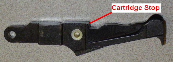

Retrieve the shell carrier from your parts pile. This is the surface that needs to be cut back to allow longer than 1.600 OAL to feed reliably.
http://www.imashooter2.com/pictures/cartstop/cs1-sm.jpg

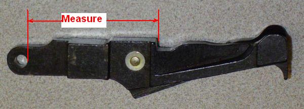

Take a measurement from the pivot hole to the face of the stop and decide how much you want to take off. I've read on Beartooth that you can remove up to .100 without issue, but since removing is easy and putting back is hard, I went with .050. That should allow smooth feeding with cartridges up to 1.630 OAL and a maximum OAL of 1.650. More than enough for my purposes.
http://www.imashooter2.com/pictures/car ... as1-sm.jpg

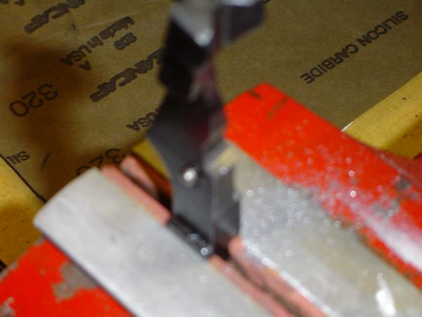

Clamp the shell carrier in a soft jaw vise and carefully remove material from the indicated surface of the cartridge stop with a mill file. Take care and keep it square. Stop often and measure from both sides to ensure you aren't getting the surface cocked. Remember, taking material off is easy, putting it back is hard. When you have removed the material you've decided on, radius the upper edge slightly as in the stock unit and deburr the edges. If you have a fine needle file, work the radius between the stop face and the body of the lifter to relieve any stress risers. When you are finished, lightly polish the worked surfaces with a little 320 paper. You could cold blue the bare metal, but I didn't bother.
Believe it or not, I took 4 pictures of the finished product. Every one is a nice focus on the 320 paper. But, since I took the picture, I'm going to make you download it anyway.[smilie=1:
http://www.imashooter2.com/pictures/car ... ile-sm.jpg
All that's left is to reassemble the rifle per Marauder's instructions and function test. I put together 3 dummy cartridges at 1.630 and gave them a try. They all feed just as smoothly as the unmodified rifle would handle 1.580.
