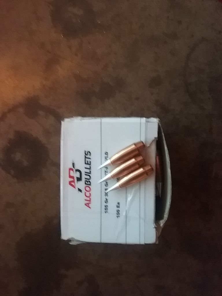

How about these, possibly the best made bullet I've ever bought. Sorry for the bad pic
