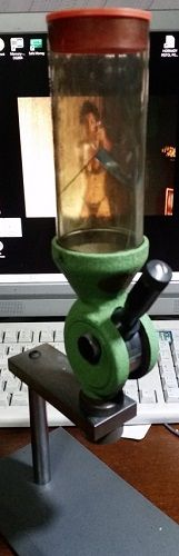

The RCBS pistol rotor has a 1/2" diameter chamber the Redding model 3 I have is @ 19.64"
Had A Uniflow rifle size a number of years Just fitted the micrometer adjuster its heavier to turn now, the Redding pistol is lighter smoother.

No it's not worth £150.00 more.
I bought a second hand Model 3 which are cheaper than the 10x tided it up a bit, made a stand out of materials I had to hand to make it easily portable & suit my needs.
I found that the Uniflow rifle rotor 11/16" did not work well with small charges of flake powder but had to use it for a while & trickle as it was all I had, the Lee Perfect has been consigned to under the bench somewhere.
