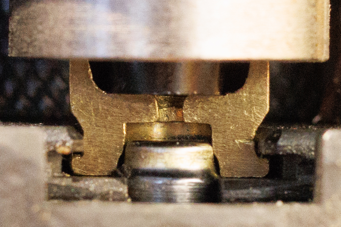

This is my swager, shown with a sectioned case which is used to adjust the depth of swaging and the position of the hold-down rod/die.Mauserbill wrote: ↑Tue Jun 06, 2023 11:50 am whereas the Primer pocket swager resizes the the walls and rim of the primer pocket.
Note that this case has been used many times, so it is massively 'over-swaged' - this doesn't matter for setup purposes.
The photo shows the swage rod at its extreme upward travel. There is a point at which the swage rod diameter starts to reduce, and this is set to be level with the face of the case head, so that the tapered (actually radiused) part forms a lead-in for the primer. Clearly the rod doesn't go anywhere near the bottom of the primer pocket, and if the rod was set much higher and you tried to swage a case (one which wasn't already over-swaged) then it would probably bend the swage rod (I've seen others bend rods by over-swaging before, and they didn't go anywhere near the bottom of the pocket). I can't imagine that there are rods which go to the bottom of the pocket with the intention of stretching the entire case-head - they would surely get stuck.
Yes, a uniforming tool cuts on the face, and is intended to cut the pocket to a uniform depth and square the bottom of the pocket; I would expect that if the pocket diameter is too small anywhere, then as the corners of the cutting edge meet the narrow spots on the way in, they might skim a little off (if the tool is spinning), but having never encountered this issue I can't say for sure.
