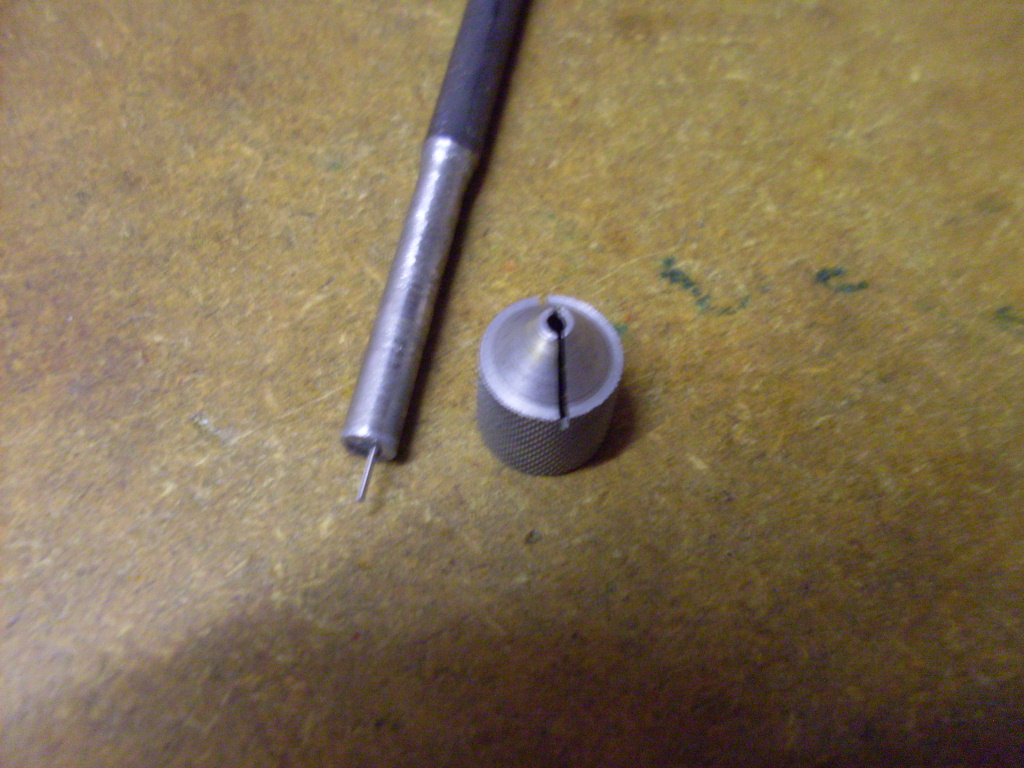

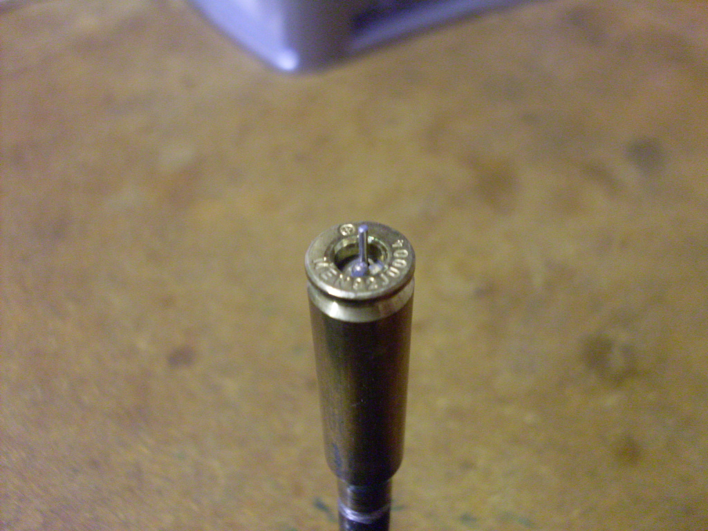

There are various ways to de-prime a Berdan case, some use water (messy!) and I believe RCBS make a de-capping tool, but I prefer to punch out primers with my home made de-capping punch. I use a modified Lee chamfer tool to remove the primer crimp.

Do you ever break your decapping pin? I have some French Gevelot .30-06 cases that will not decap with the Wamadet hydraulic decapper. Out of ten cases tried, only one decapped so I gave up. The primers seem to be well sealed and crimped. I have the RCBS Berdan decapping tool, but that does not seem to work on these cases, it just pulls through the primer. I don't want to do that any more as I am likely to break the pin. I could do with something like your tool. I could try it on some military 8MM Lebel cases I have. These are too big to fit the Wamadet cylinder. I know Wamadet did a bigger cylinder for .577 Snider and Martini-Henry cases, but I don't have that one.
Yes I have, I use the shank of a broken 1mm drill bit for the pin, fixed with Loctite into the punch.
The trick is, to make sure that the pin is located in one of the flash holes before hitting it!
