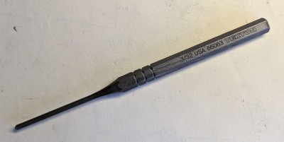

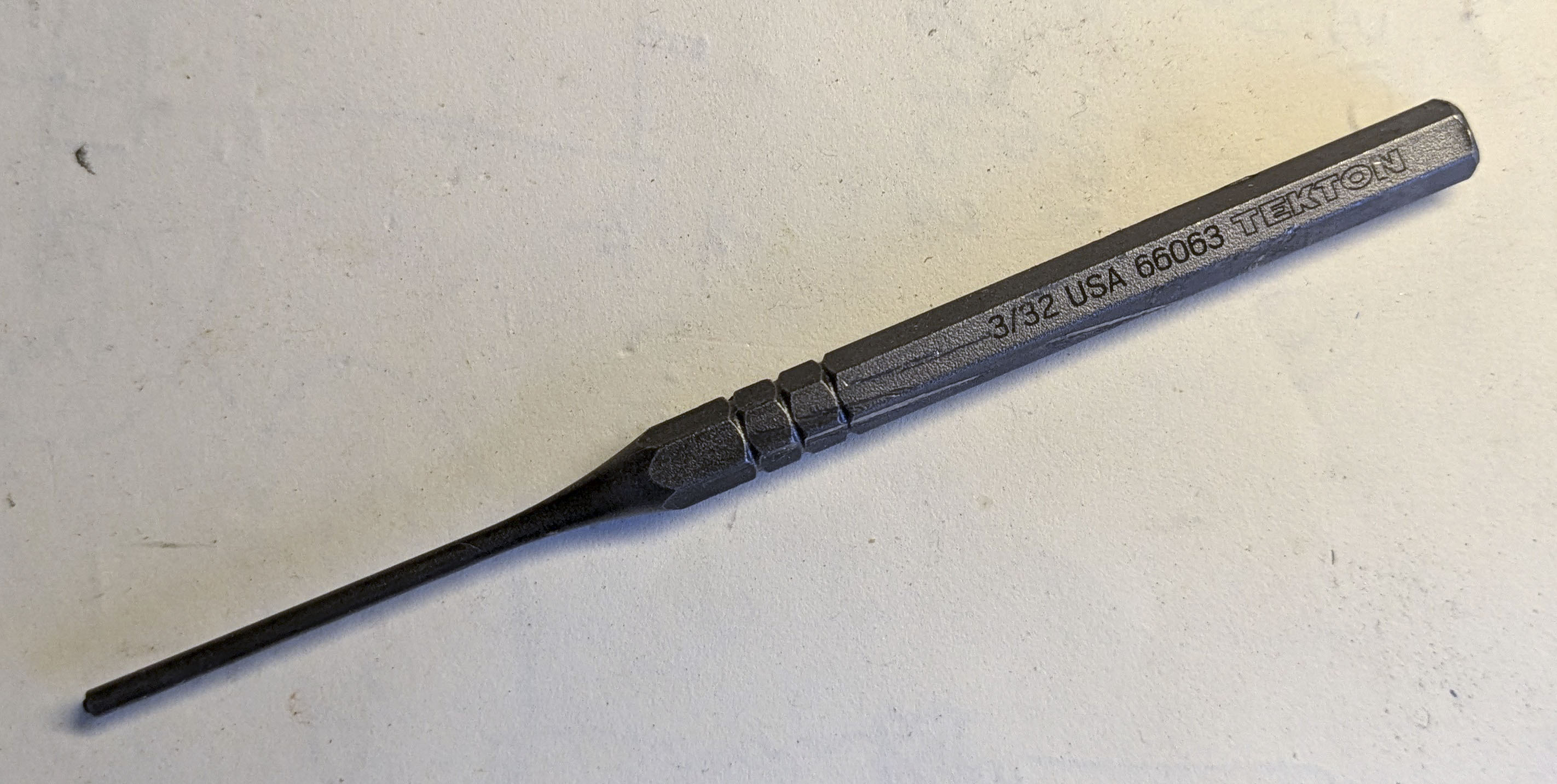

The bolt release tool from Brownells is a pin punch flattened on one side, which makes it easier to remove the pin.
If you can flatten one side of your pin punch, it will definitely help.

Thanks guys. I think what I need is a roll pin punch to locate it better but I have several plain punches so I can try flattening one.

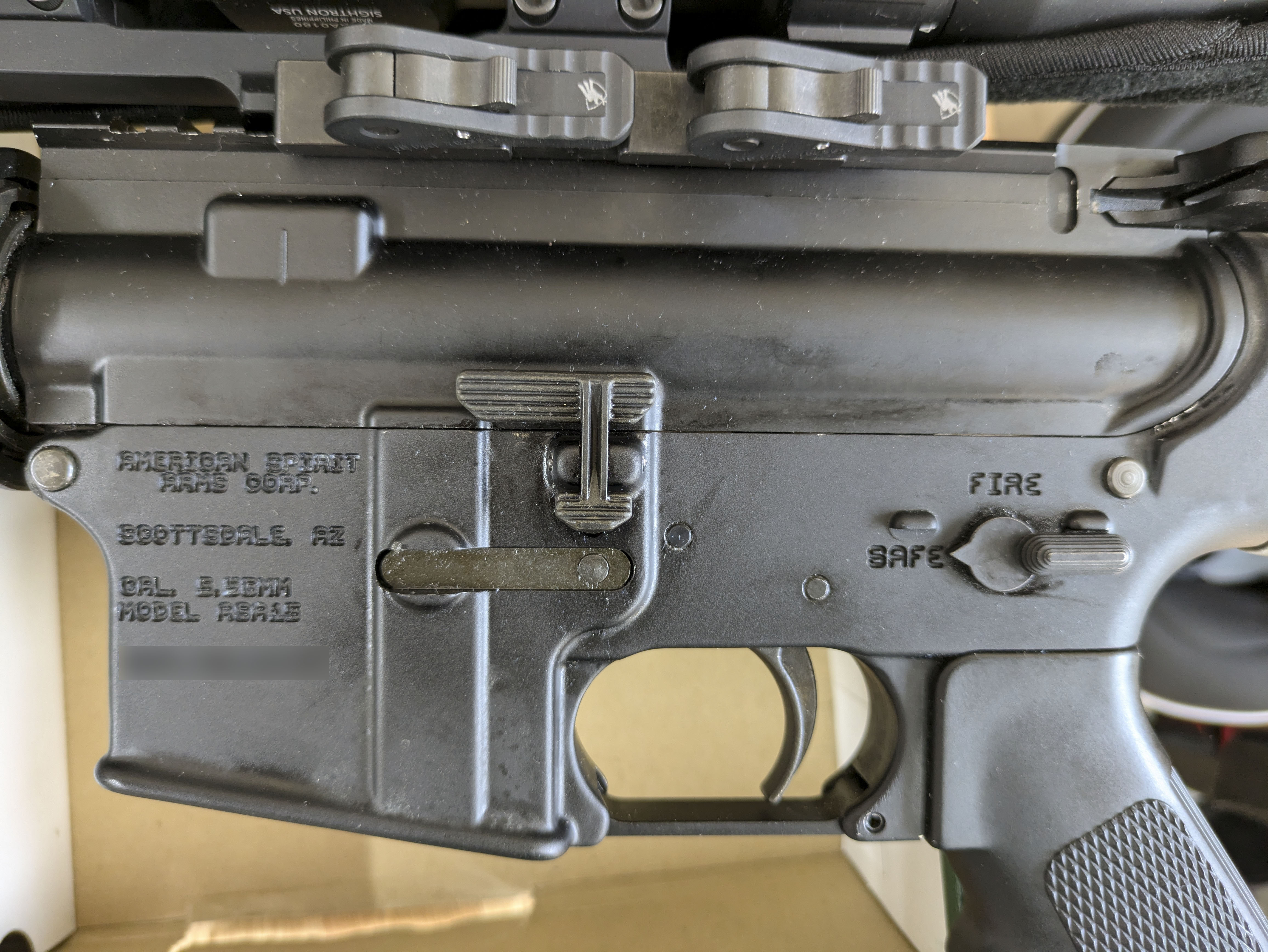

I finally got around to completing this job, which was to fit an extended bolt release catch. I bought a quality roll pin punch made by Tekton on Amazon (with free shipping from the USA

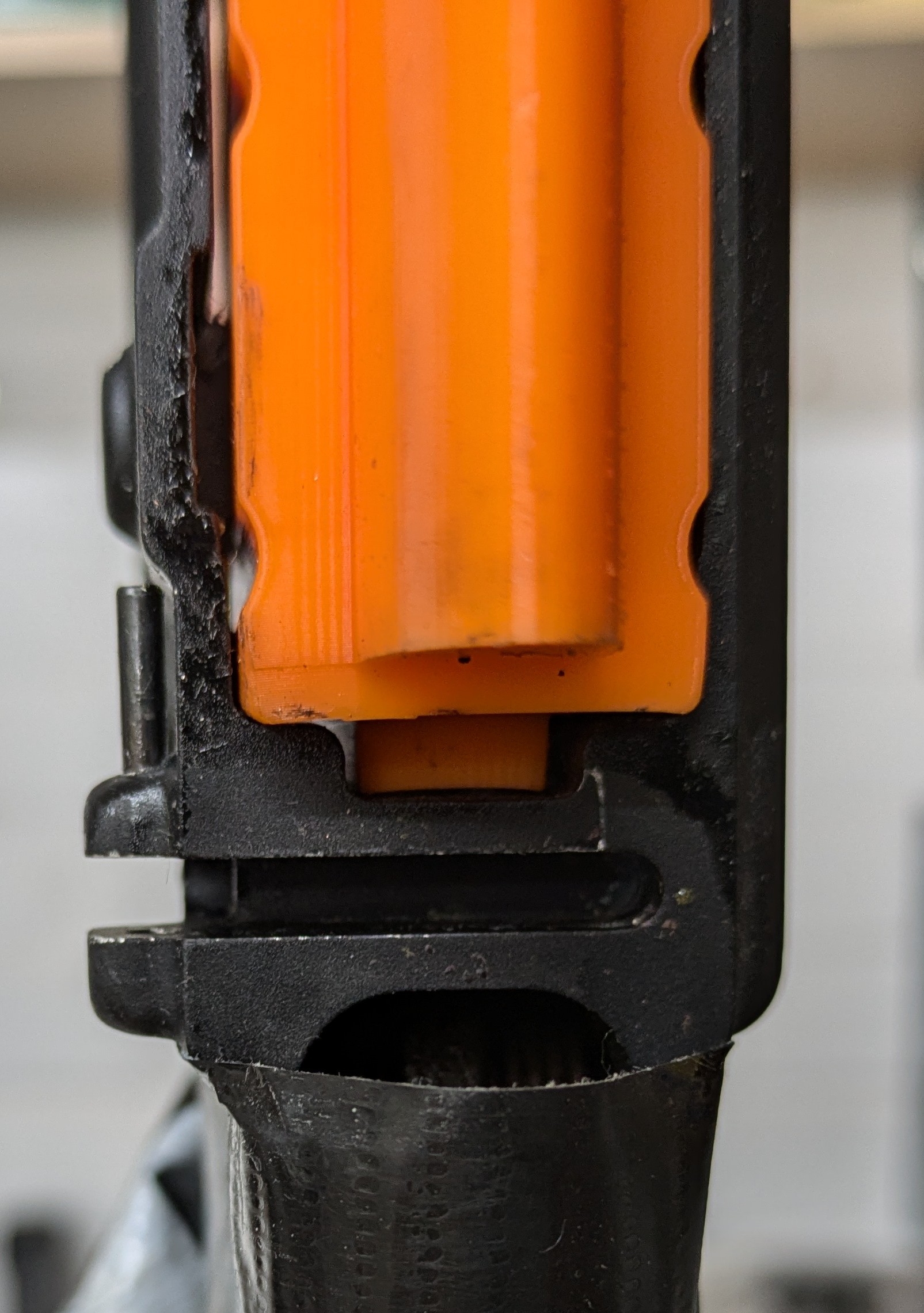

I removed the butt stock and knocked the pin out towards the magazine well. I was planning to replace it with a new pin provided in the kit, but a ridge on the receiver prevented it from coming all the way out.
Not an essential modification, but a friend sold me the catch for next to nothing so I thought I'd fit it anyway.
