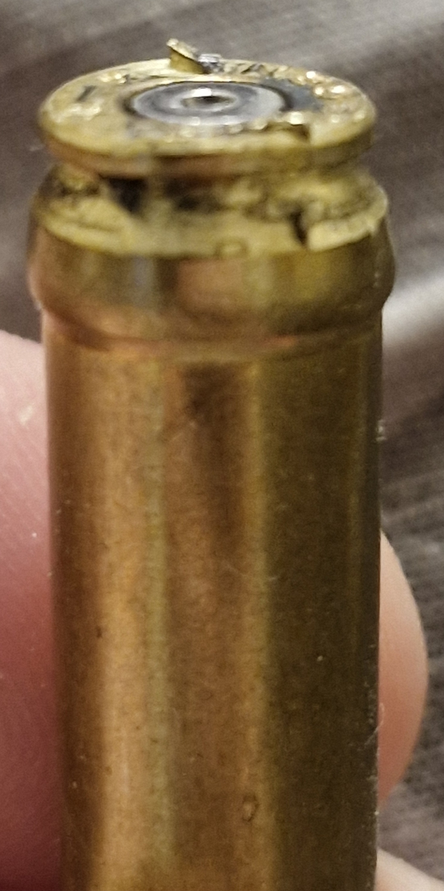

That looks more like over pressure round than a chamber problem.
The bottom part of the case is not all contained in the chamber as it's where the case sits in the bolt face and there is a small gap.
If a firearm fails proof it is usually returned to the owner, still cannot be sold or transferred as it is not in proof.
If this is a loading issue then the barrel is most likely OK (for now), if the chamber is very tight then that could cause pressure problems.
The Barrel may not be scrap, it could have the chamber re-cut or even set back by taking the barrel extension off and shortening the barrel slightly and then re-cutting the chamber again. The rest of the upper is not pressure bearing so shouldn't be distorted, unless the case ruptures.
This is very specific for a hypothetical instance
I'd like to see the barrel before passing it on, also see the stated reason it failed proof. As I said above this looks like an over pressure situation which, if contained, is what the whole proof procedure is meant to check. The rifle didn't fail, the cartridge did, and almost catastrophically.

Thanks for all the info, don't want to get into specifics at the moment. I'm also wondering what sort of damage could it have done to the bolt and carrier and how would I even check?
