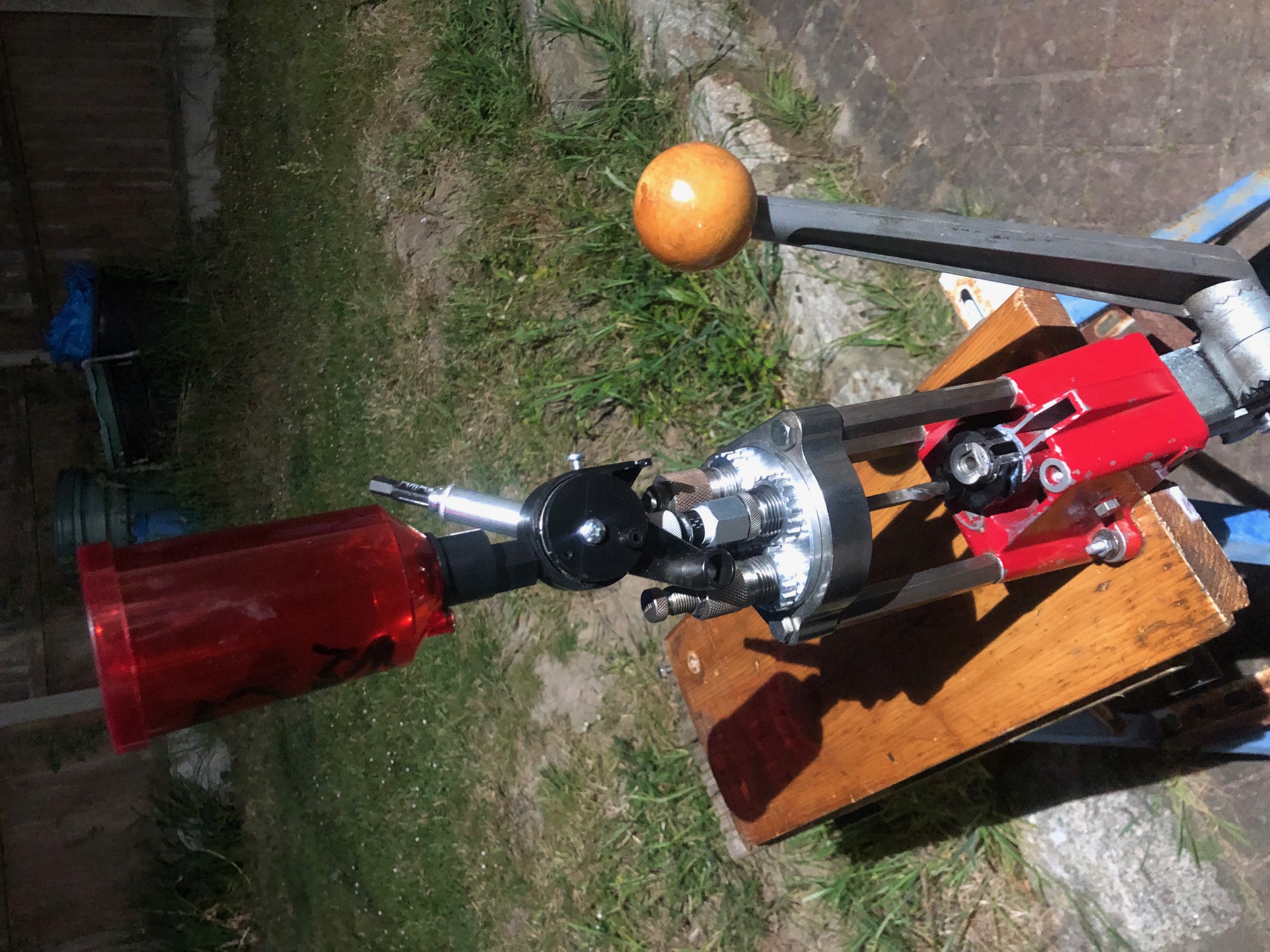

I have one of these but neverreally got round to using it basically as I was loading 38 special and 223 with cast bulets and squib loads.
The problem was repeatability.
I took to customising dippers which really worked well until I bought my rossi r92, my ammo consumption rocketed from very ittle to several hundred weekly so I ask the question, is it possible to get 6 grains of Lovex D036 to meter reliably and accurately with one of these or should I swap to a meter with fixed charges? I'd prefer not to as I've started bumping out 223 with barnes varmint grenades at the rate of about 50 per hour on my early lee turret press.

I have my PPM set up to fit on adaptors I made that push into powder through dies, it works quite well. There' an image hereabouts that shows mine.
I've just been reading up on the lee auto powder measure I may go down that route, especially for 38 loads.
The PPM is set up to throw 27 grains of lovex D073.6 for my 223 with 50 grain Barnes varmint grenades. The dies in the press are 357 magnum ones as I'm loading a couple of hundred tomorrow and will set it up first thing whilst the good weather holds.

Channel 12 I checked every 10th load. Within a couple of tenths of a grain.
Your's isn't a bad idea, I load 4calibers, 38, 357, 30/30 and 223 and I'm pretty much standardised on them all except the 30/30 may pay me to buy some secondhand ones.
