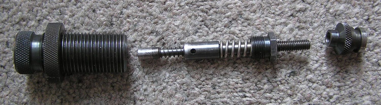

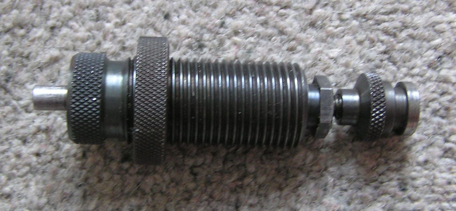

I have been using an old RCBS Posi-prime hand primer. More recently, I have been using a Wamadet Primaline hand press and a Prime Reloading ram prime die. I still use the RCBS Posi-prime for priming .310 Cadet cases but use the others for priming large rifle primers, both Boxer and Berdan. The ram prime die works well and I mostly use that.
Peter.
RegardsPeter.
