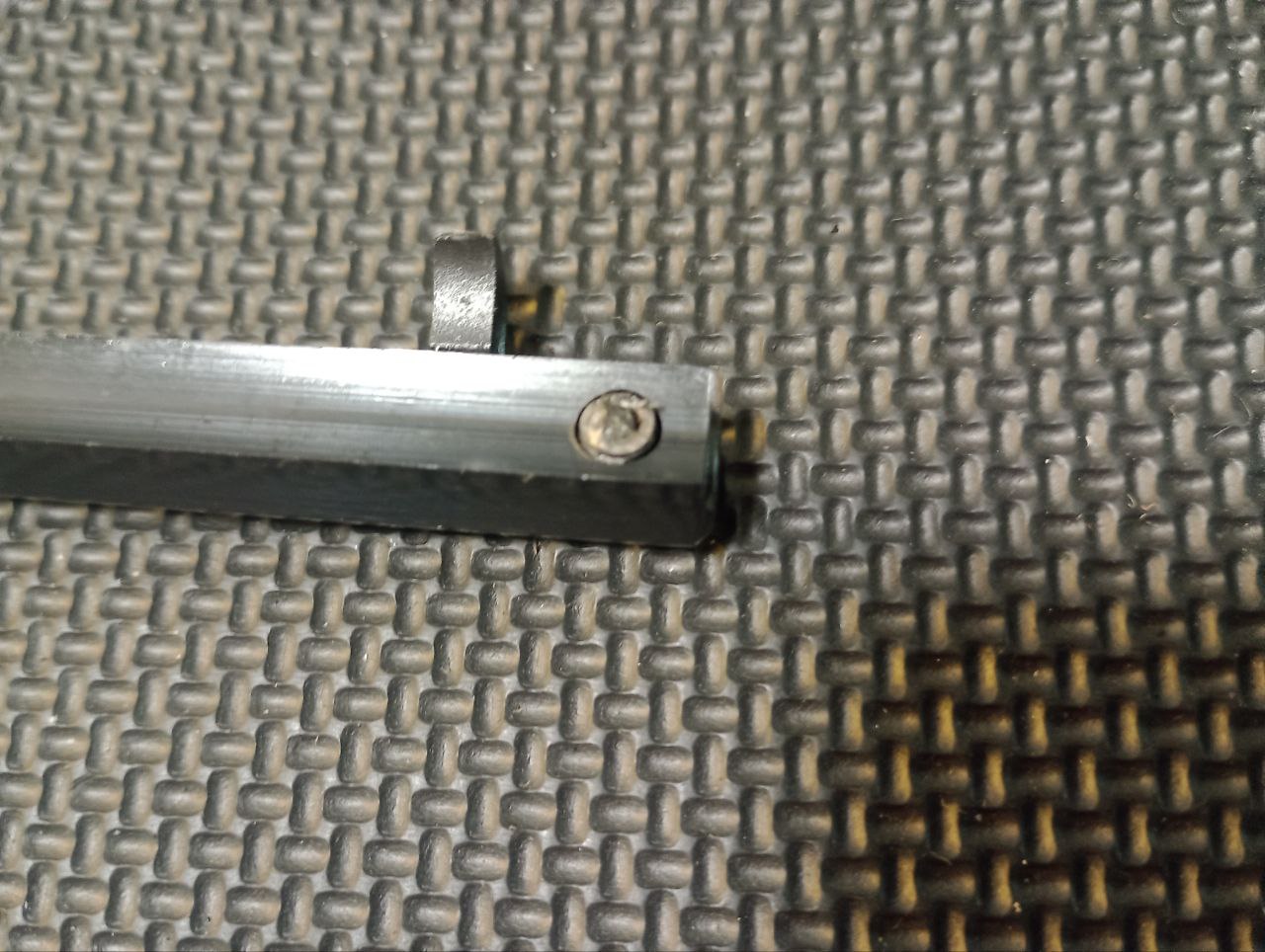

I bought my Pietta 1873 SAA new a little over a year ago - long enough to just be out of warranty.
I use a light charge of black powder pushing store bought lead balls.
The faux ejector mount fell off today. It looks like there's a threaded insert silver soldered or pressed into the barrel for the retaining screw. Some of the insert was still attached to the screw.
Has anyone else had this happen to them? I was a tad surprised as I know Pietta sell this gun in the USA with the cylinder machined for .45 Colt, so it ought to be able to take the recoil without issues.
I will most likely plug the hole and make good the bluing, as the ejector is just a cosmetic feature.

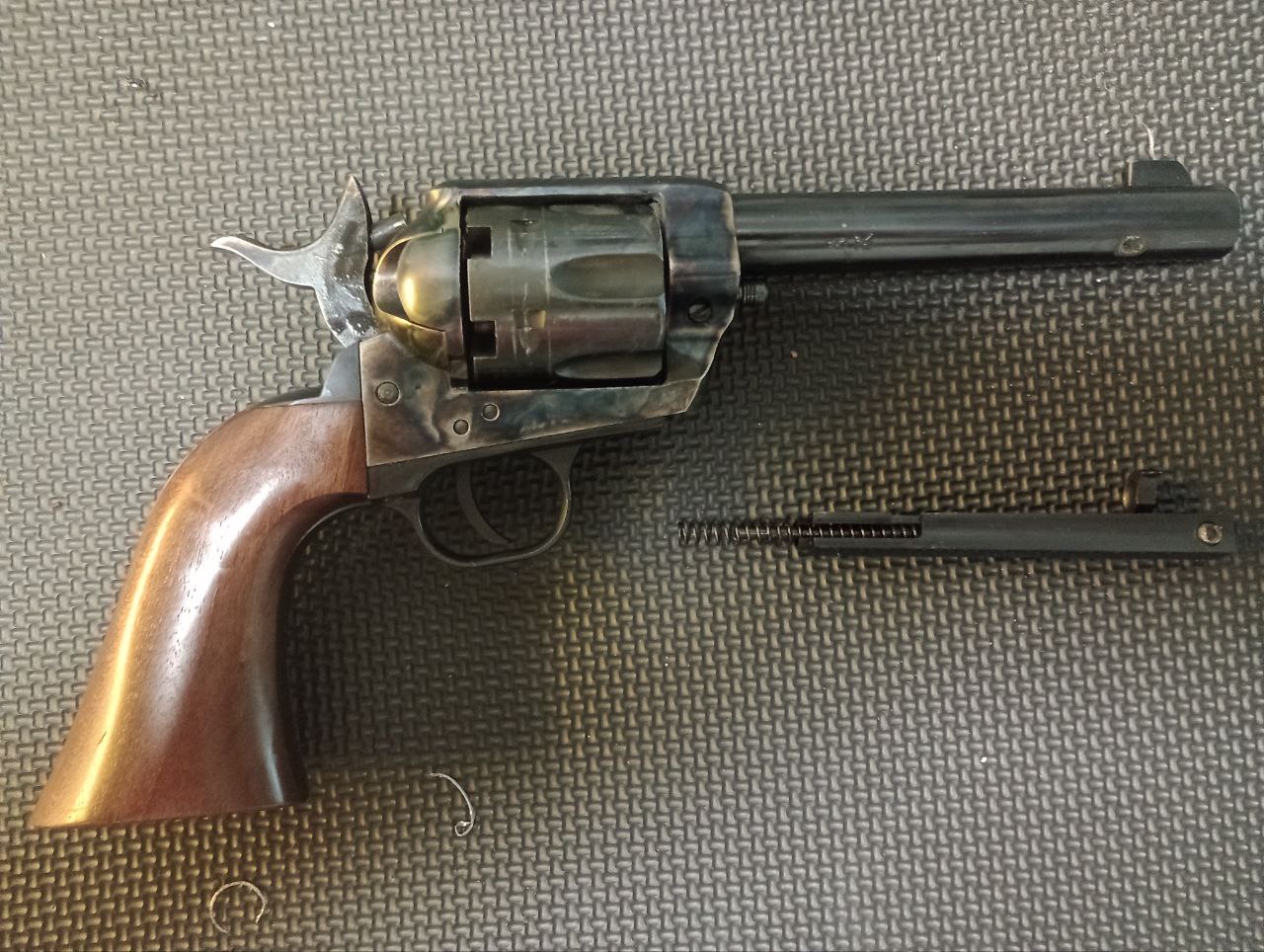

not had what you describe happen, but had it fall off plenty of times. but all my 73's I have atm are Ubertis. there isn't exactly a lot of meat to fix into, so my ejector rod retaining screws do come loose around every 30 or so rounds. one trick i've seen is to do them up, then drill through the screw, inside the end of the tube, parallel to the barrel. then insert a roll/spring pin into hole to stop it turning and loosening.
the other thing that helps is to take the spring and ejector rod out of the housing, so when the spring does loosen, as there is no tension, it will rattle to tell you it's loose, and if you don't notice and it does fall off, it all lands at your feet, not propelling itself 5yrds away.

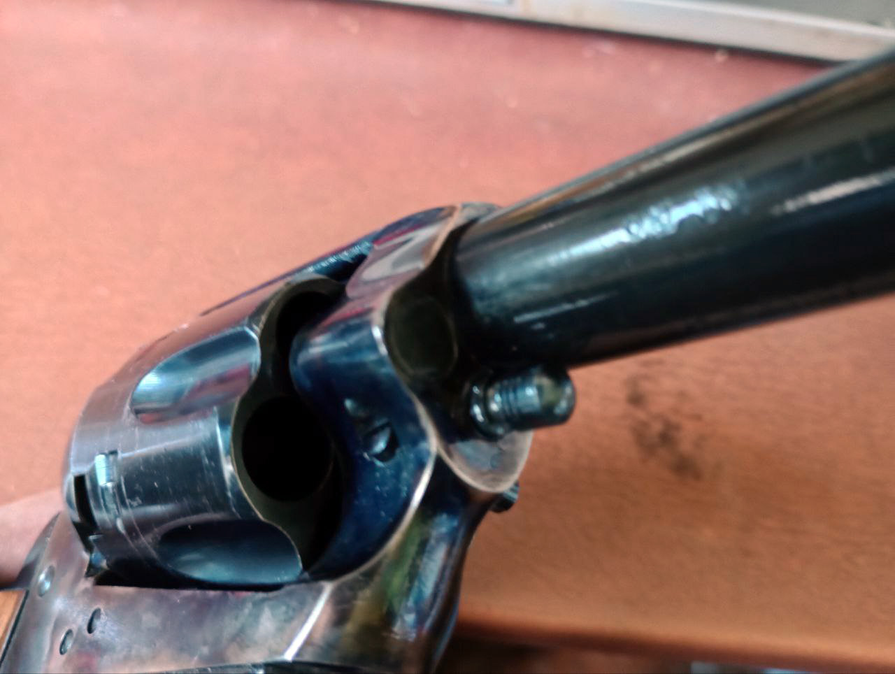

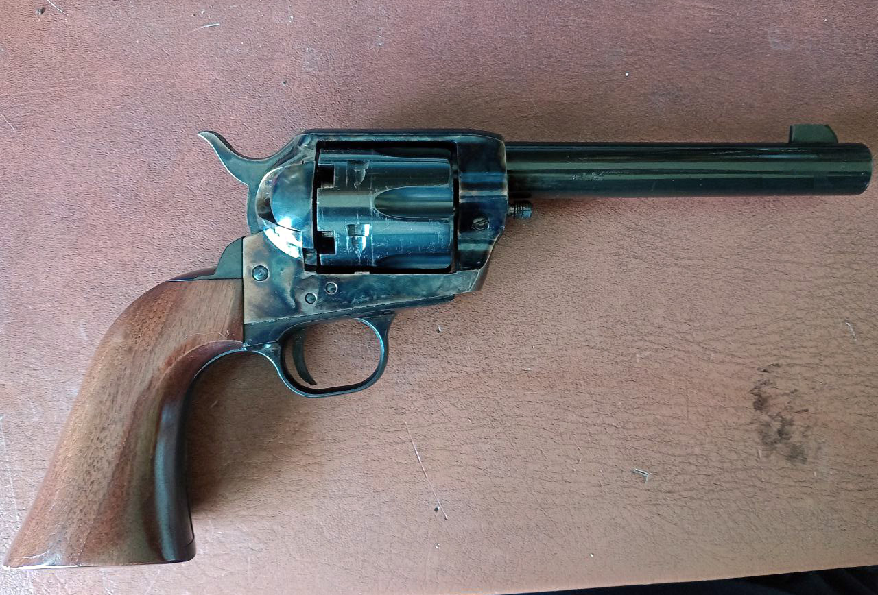

That's the route I've taken. Silver soldered the hole and tidied up. Prepped and blued the entire barrel. Plugged the frame where the ejector rod passes through using a suitably sized piece of bar steel utilizing bearing retaining fluid and an interference fit. Then blued it. Looks rather nice. Reminds me of one of the early Police .38s

Forgot the pics. It didn't happen if there aren't pics!

BTW. I was going to put the head of a steel tack in the hole and solder in place, so it could be blued. This was annoyingly fiddly. I gave up and filled it with solder. I blended in the silver solder to the Perma Blued barrel using something called Liver of sulphur. Sometimes I make jewellery and I use this to blacken silver for contrast. It's not perfect, but it's acceptable.
