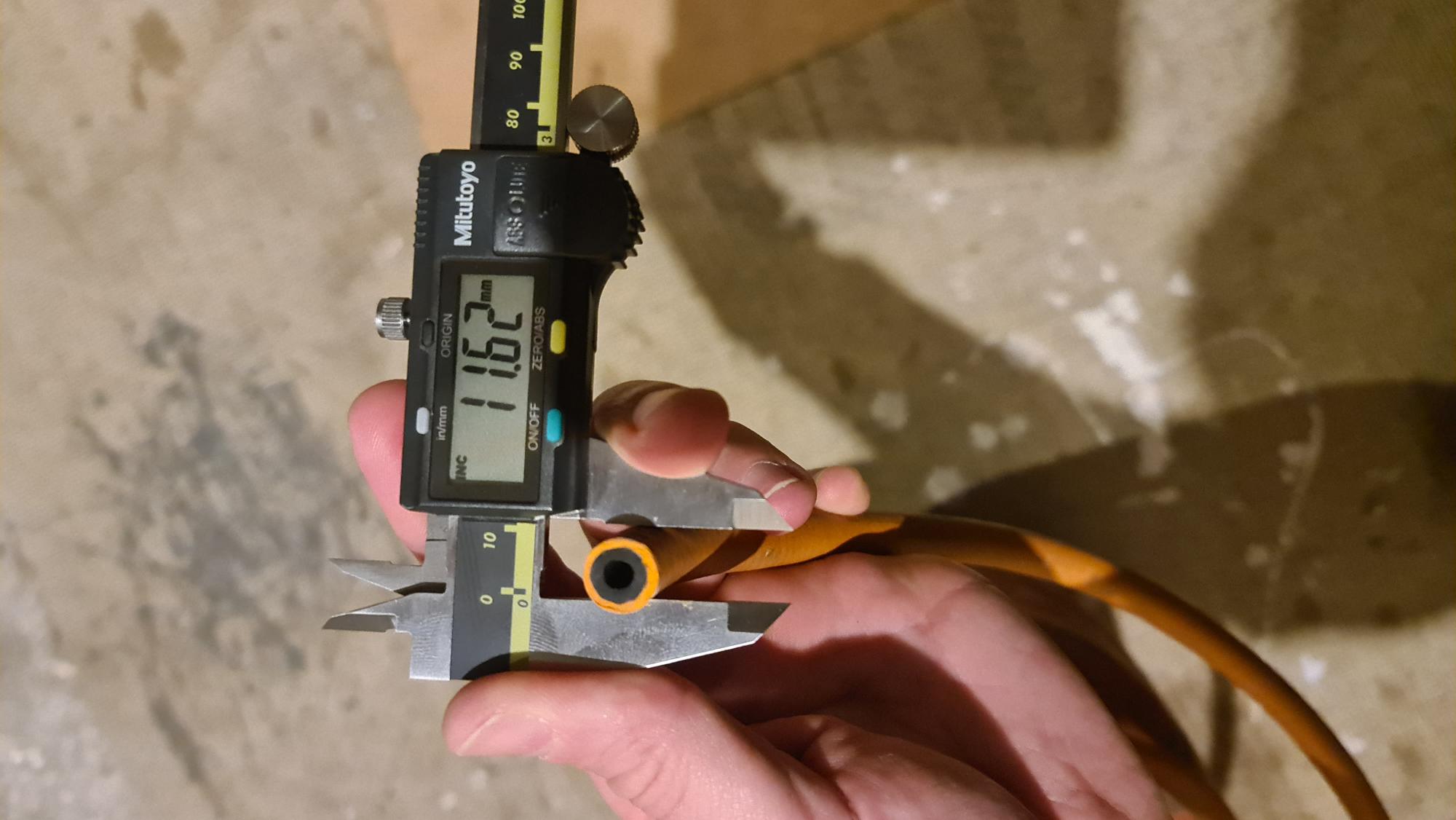

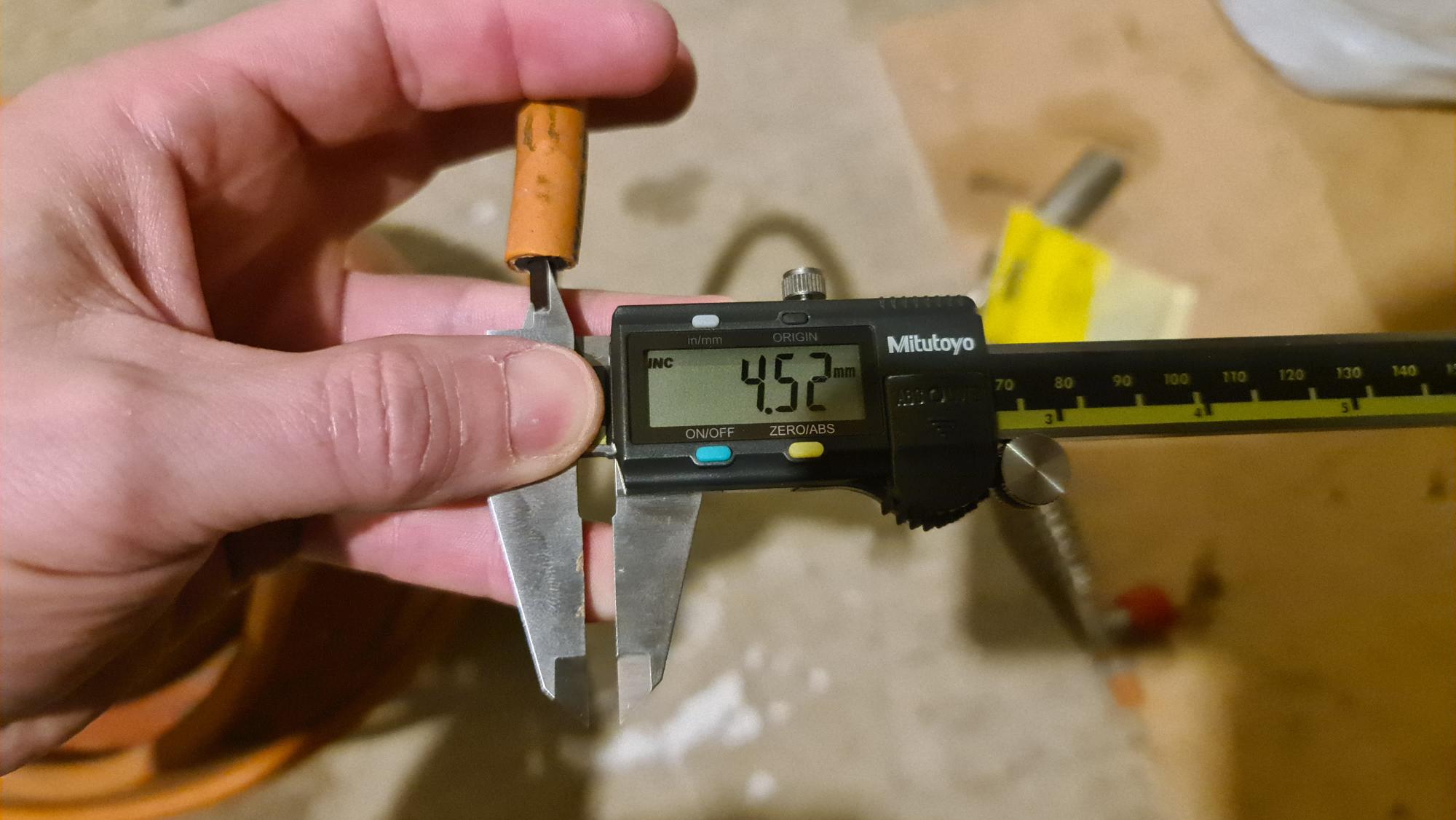

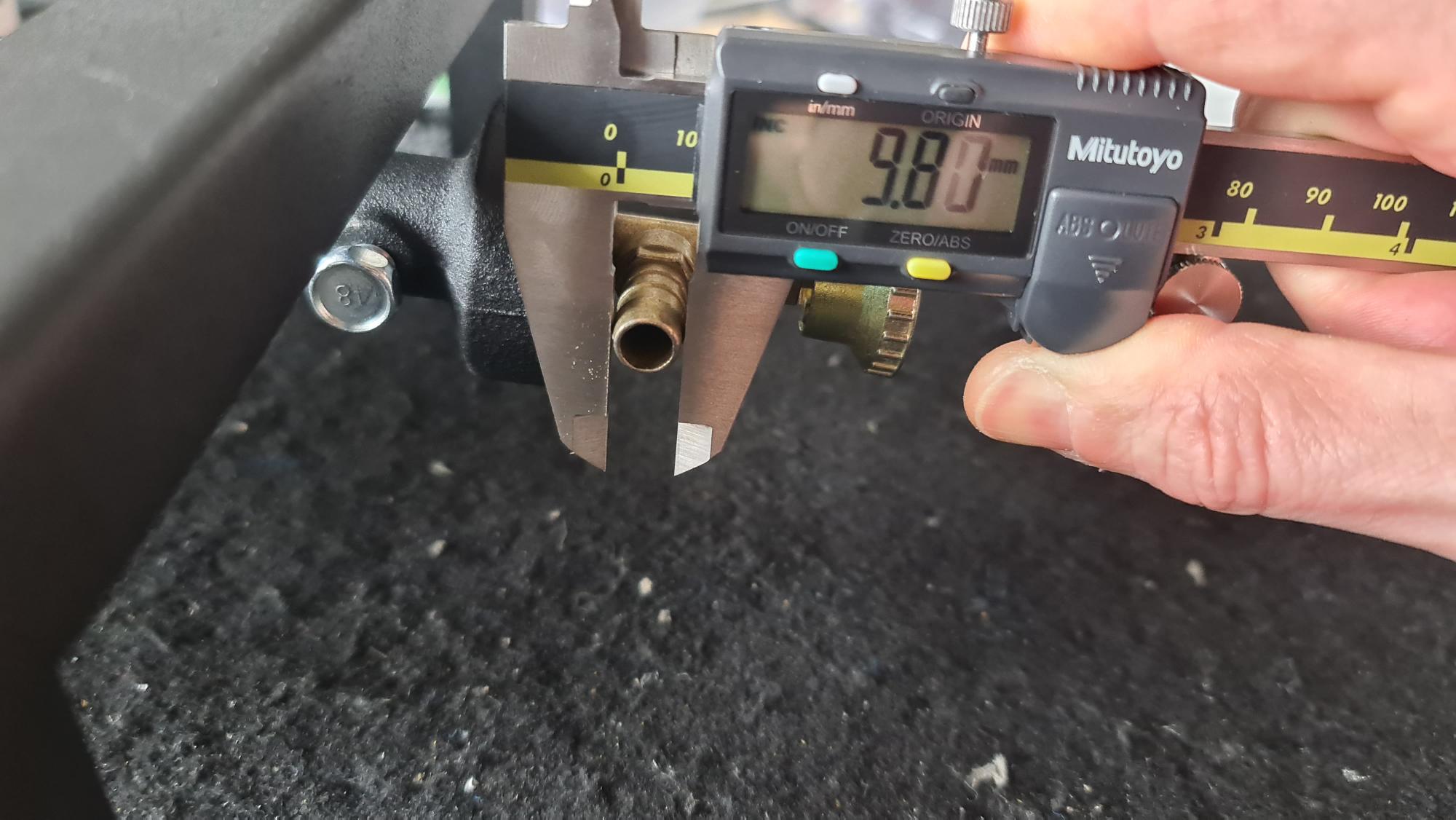

Hello all,
I have a ton of lead that needs cleaning/cast into ingots so I decided to get a dedicated tank fed burner to make things more economical than the previous gas canister fed burner I had been using. Its been nothing but a headache ever since!
Anyway, I have a propane tank with regulator and hose but the hose hole diameter is too small for the valve on the burner. The valve on the burner is 9.8mm in diameter (at its widest) whereas the hose has an internal diameter of approx. 4.5mm.
The valve on the tank is going to be the same small diameter as the hose naturally so its not just a case of buying a different hose. Is there a way around this or am I going to have to just buy a whole new regulator/valve and hose for the gas tank that fits the valve on the burner?

unscrew the barb, and order another one with a smaller dia?

There's been a shortage on Calor 47kg propane bottles for months now. Flogas bottles can be sourced without issue though and take the same regulator.
Google LPG hose and fittings, there should be larger sizes available, and also note you may need a higher or adjustable flow regulator as your normal BBQ regulator may be too low flow. Your burner spec should state the KG/hr rating to allow you to get the right regulator.
