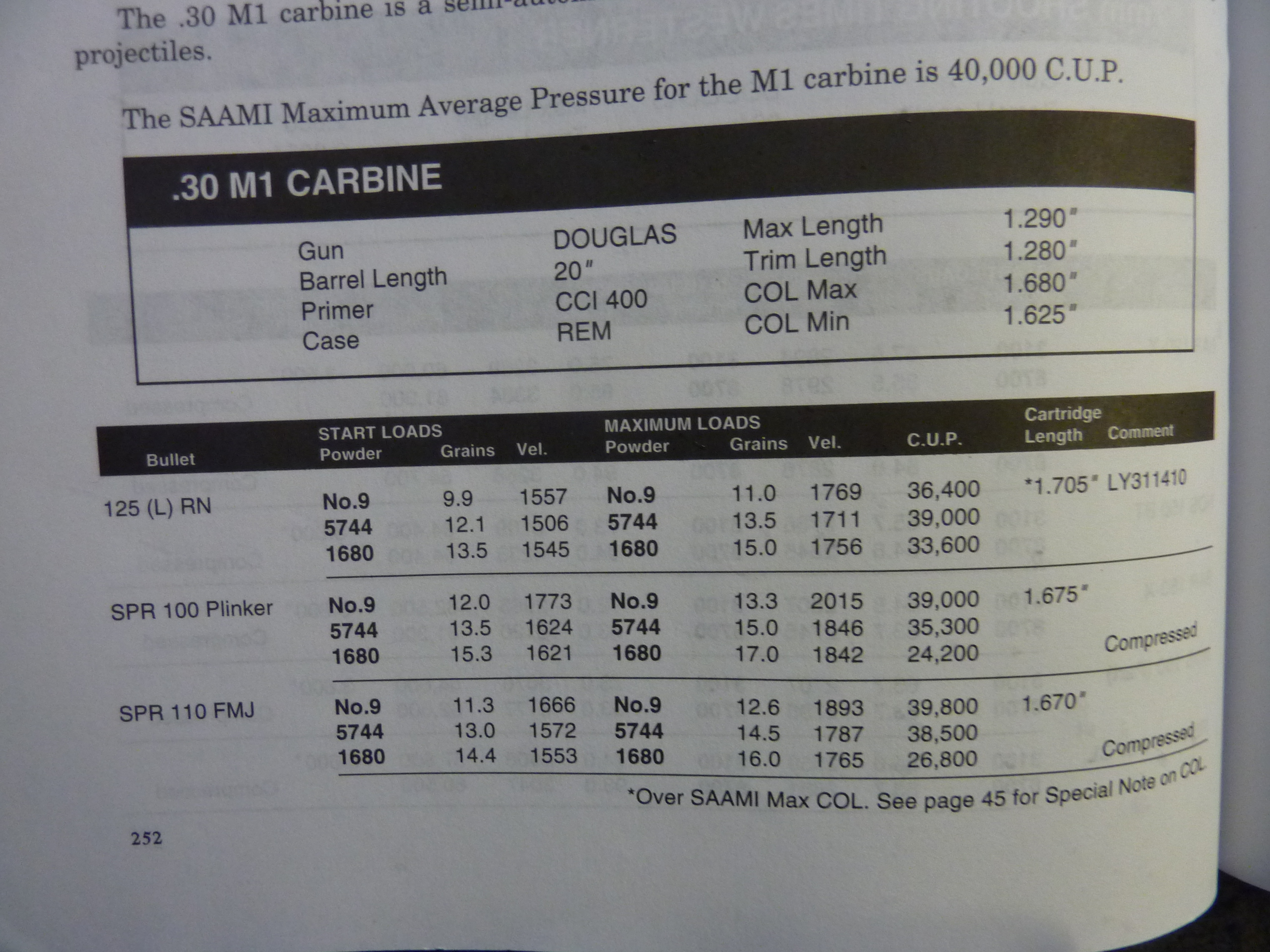

Has anyone used Accurate 5744 with 115 grn lead loads in .30 M1 Carbine?

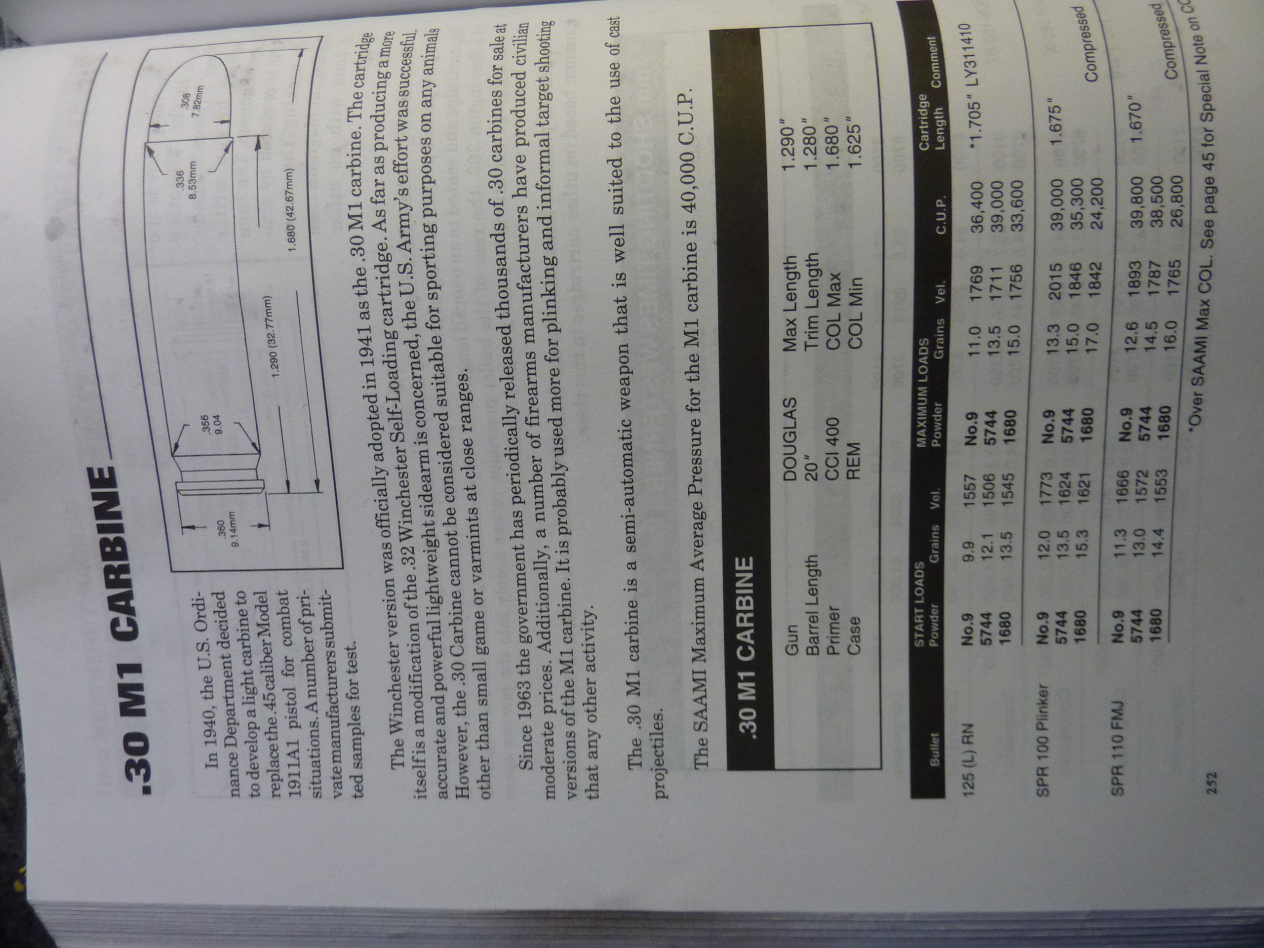

I have used this accurate powder with great success in large case calibres, as it is a bulky cylindrical power made especially for that type of use very good in my 45/70 and large obsolete cases. No longer called 5744 It is now called D60. I have the Accurate reloading book if the load you are interested is in it I will post on the forum for you.

How much should I reduce starter load for 115 lead grain bullets?
