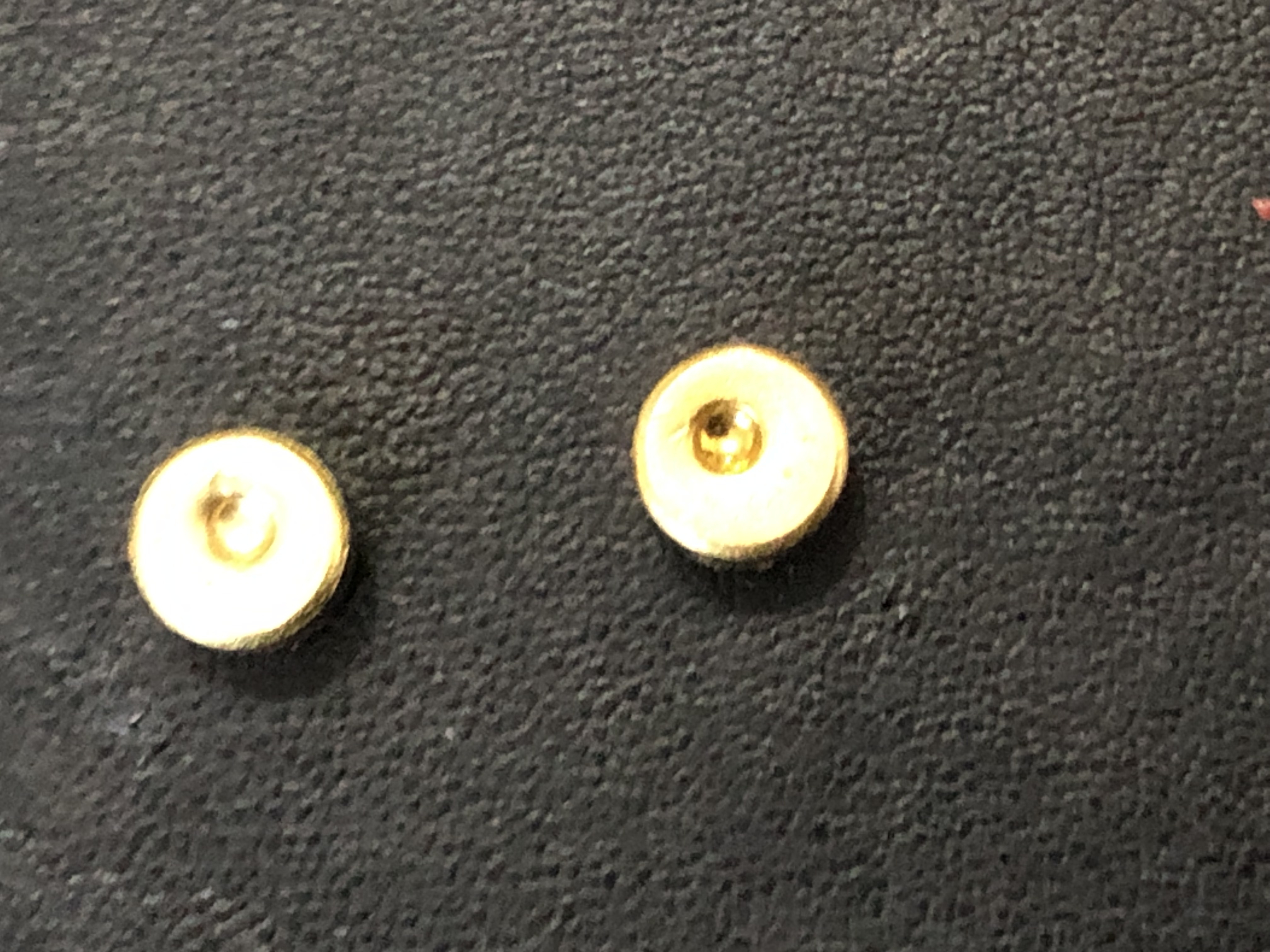

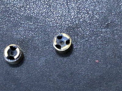

I've slept on it and the only conclusion I can come up with is as follows, the S&B primers have 3 legs to the anvil, the Magtech don't. The magtech primer is on the left in both instances, The magtech primer was fired out of the gun in question but the S&B one wasn't.

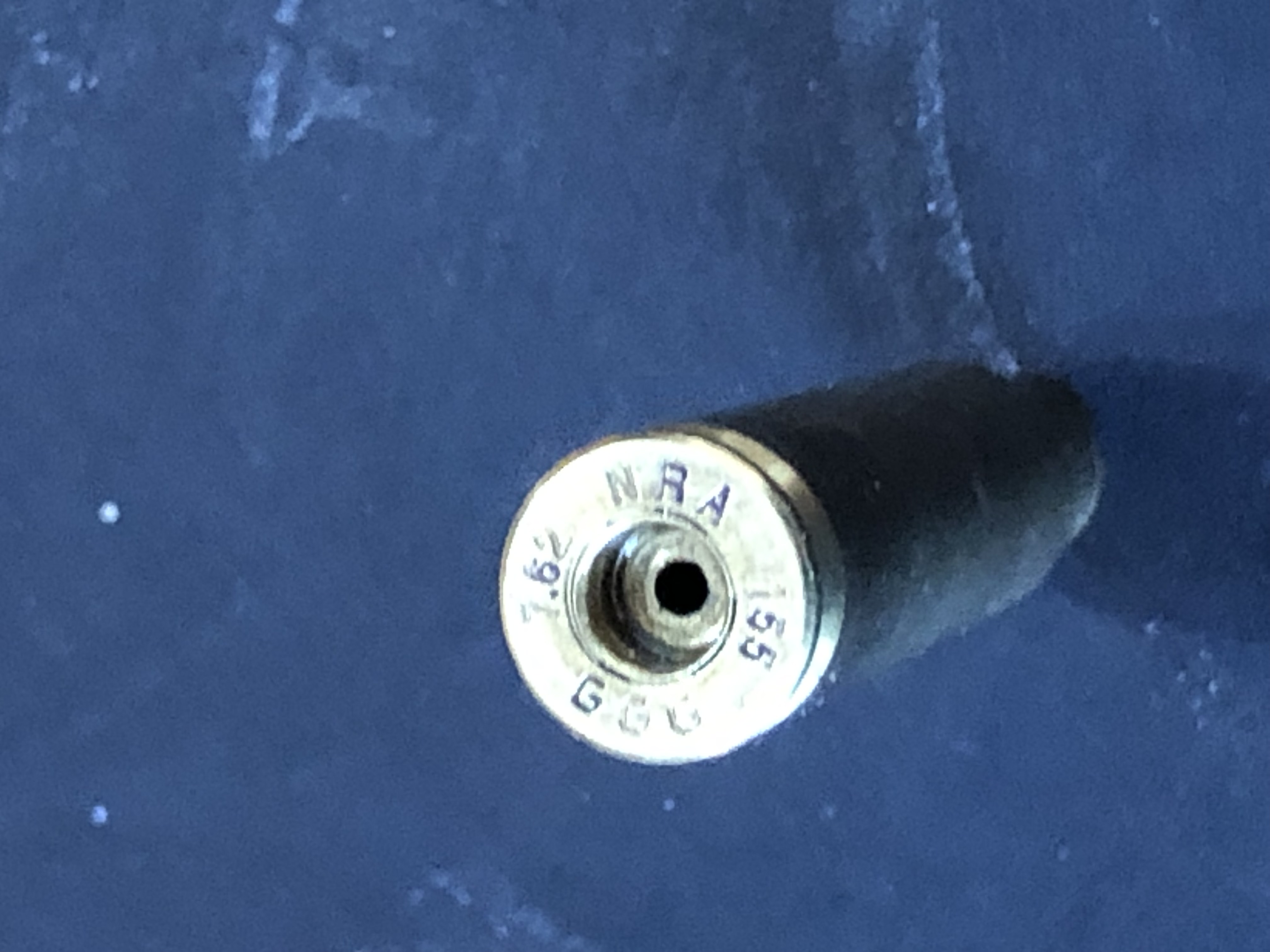

This image shows the case head which has already been reamed using the lyman LR reaming tool. The annular ring showing where the case has been swaged is still clearly visible.

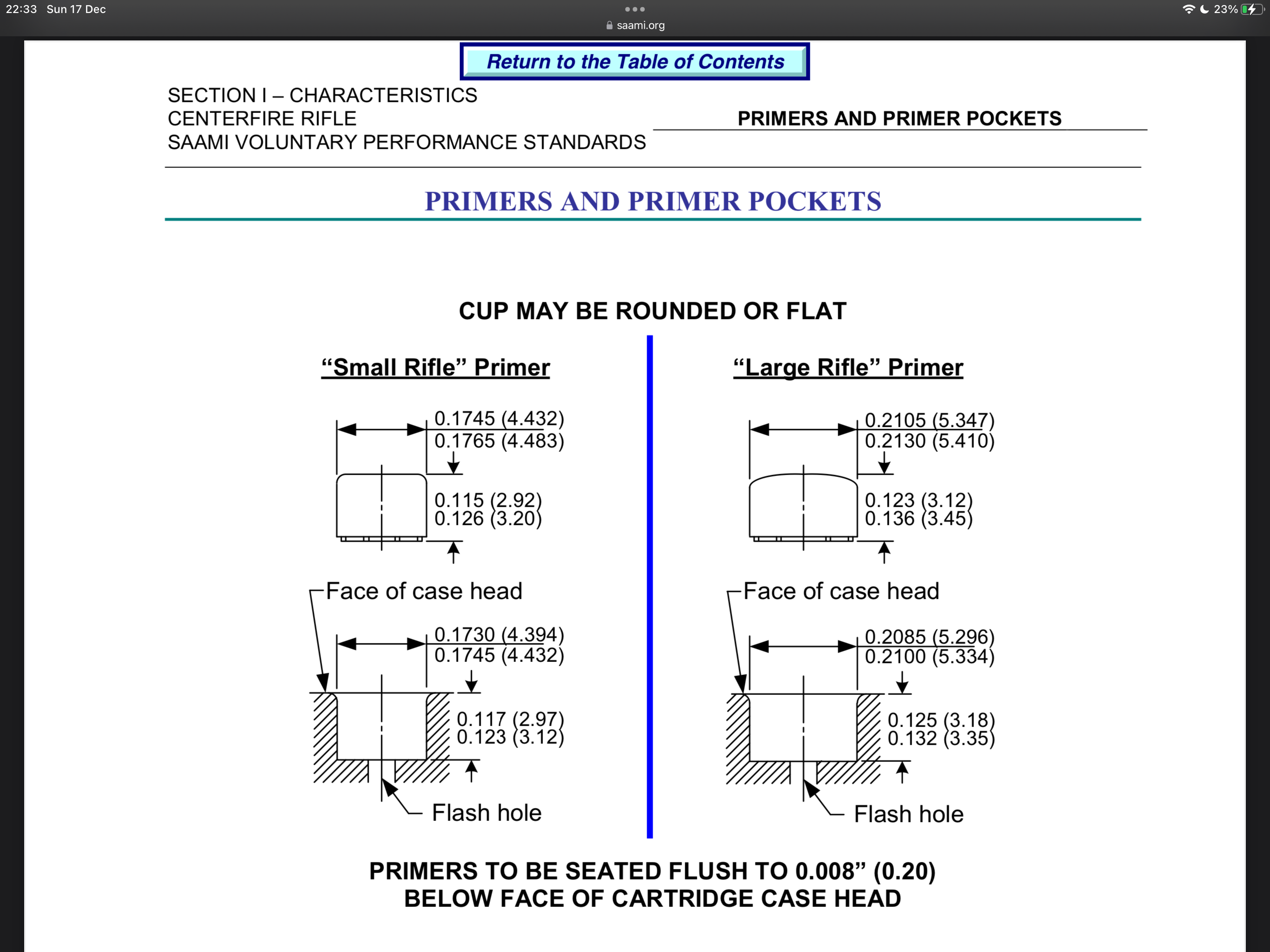

SAAMI information.
![Image]()

Thanks for the info. Re the photo of the case head, this was after the application of the lyman pocket reamer but before using the lyman case mouth chamfering tool. I took a picture of the loaded ammo just before I salvaged them and it should be nearby, I think it will reassure one that the primers are deep enough, too deep according to my range control officer and I have to agree with him.

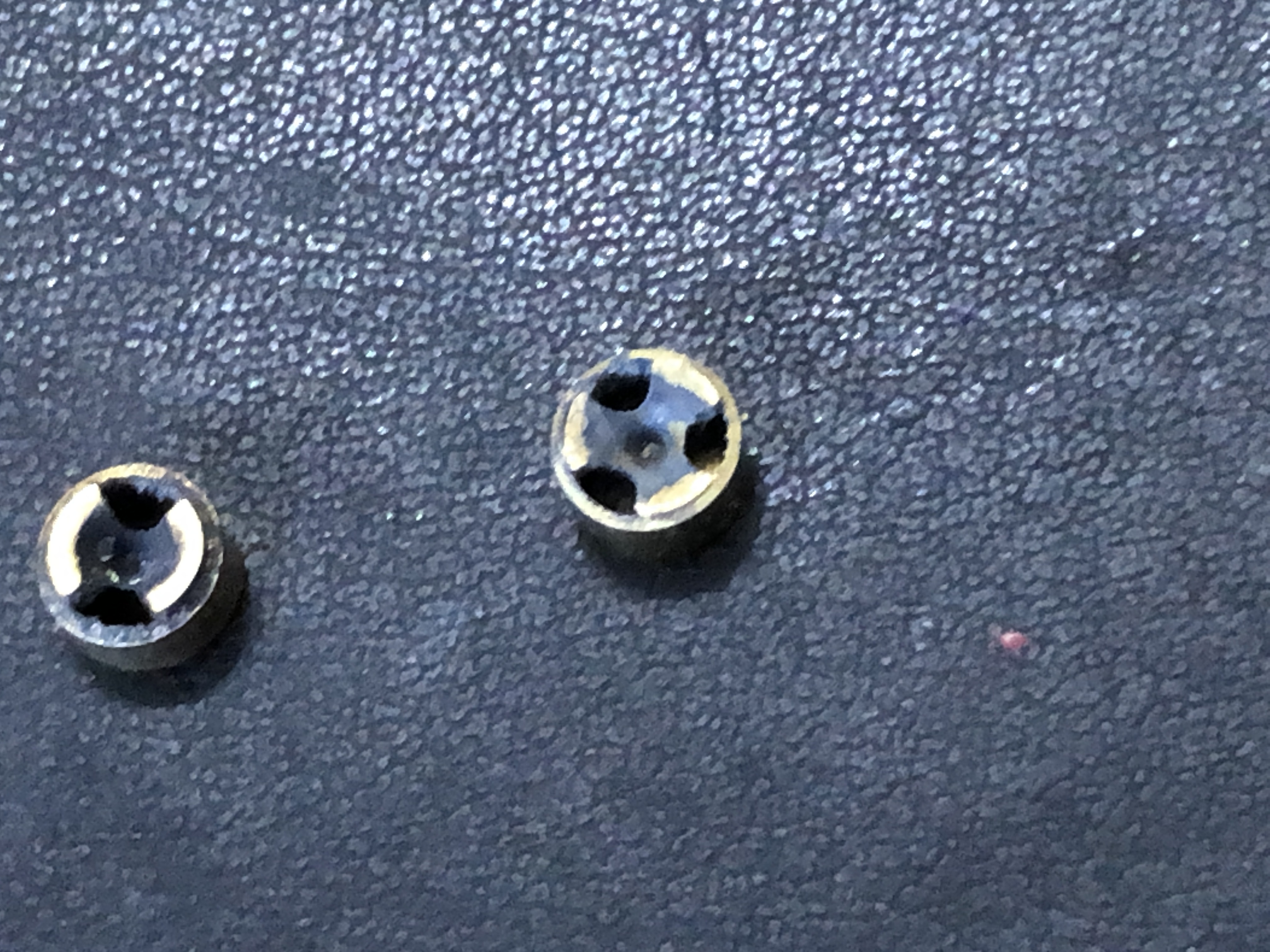

As I mentioned, all the primers when removed from the cases the anvils fell out; About six months ago I removed many primers prior to offering the brass for sale and they were S&B primers, none of those exhibited the lost anvil syndrome. I subsequently bought a new to me 308 and decided to re-use the cases after recycling the S&B salvaged ones in my 30/30, all bar 10 that is.
Rox pointed out that it looked as though the reaming had been carried out non-concentrically, that's quite possible and I wondered if it managed to ping the anvil out when I was seating the primers, I don't know is the answer.
The design of the magtech primer is different to my norm, being a staunch user of S&B in recent years but the spacer in between the anvil and priming compound in the magtech primer cup looks like white polyethylene as opposed to a small wad of whatever in the S&B variety, though I've only ever seen those after firing, they all but disintegrate upon disassembly then as opposed to the magtech which still resembles polyethylene though much blackened. ( I read an american method of refilling primers and I wanted to convince myself it was possible.)

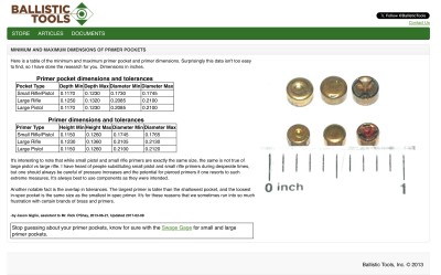

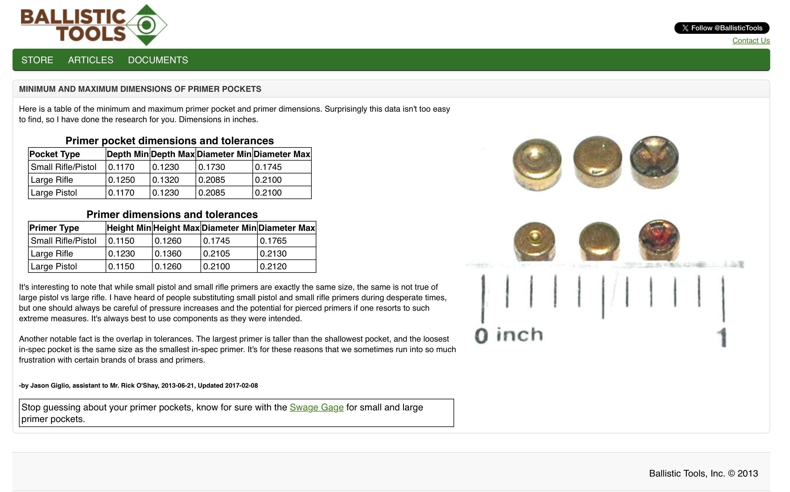

Have you measured the height of the Magtech primers and compared with other types? Also the pocket depth of the GGG brass vs other brand? and the seated depth from face of case head?
I don't have any Magtech samples to measure but this page gives the height as 0.120". Compare with the following that I have to hand:

Maybe there is some combination of the shallower primer, rifle headspace, firing-pin protrusion, placement of the case shoulder that is causing the issue.
Ultimately, if the pocket is in-spec and no deeper than other brass, then how can the case be responsible for the problem?
0.125" Ginex

And I have seen the anvils fall out of magtech primers that have been pushed back out. They really are a one way thing.
I would be measuring depth of primer pocket and depth of the magtech primer to ascertain that the require depth tolerance can be met.

Rox, I measured the depth of the primer pockets in several fired pieces of brass, GGG came out at 0.129" just after the one firing, Federal was 0.128" after multiple (maybe as much as 10 firings)

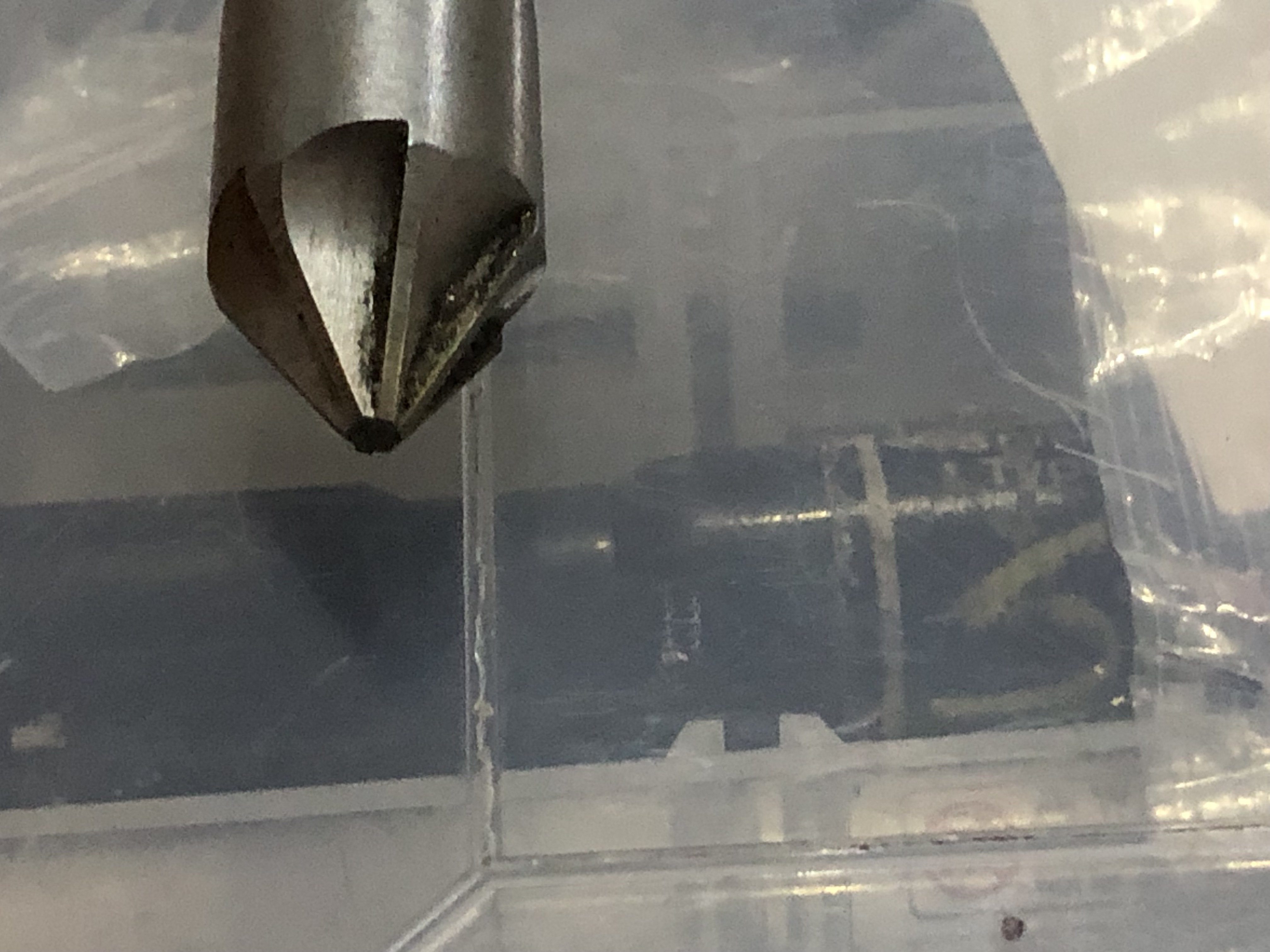

there's an image of the tool I used to chamfer the edges of the primer pockets, after the initial ream job when I felt the force required to seat the primers was excessive, it eased up a little but nowhere near as light as the force needed to seat the same primers in federal cases.
