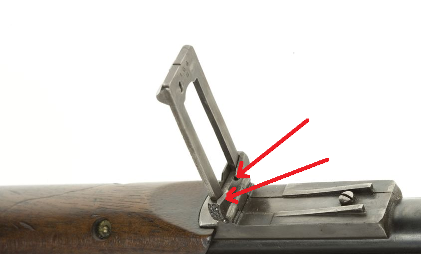

With the loose rear sight the normal procedure is to gently peen down the "wings" on the rear of the slider bar until the desired amount of tension is reached. Most of them are loose and they would have been adjusted by the unit armourer. You only need the bar in the vertical position for shooting at 400+ yards.

Thank you for the tip on adjusting the friction on the horizontal bar. I was expecting something a bit more mechanical but being so small it might have been difficult to make something sturdy enough for army use.
