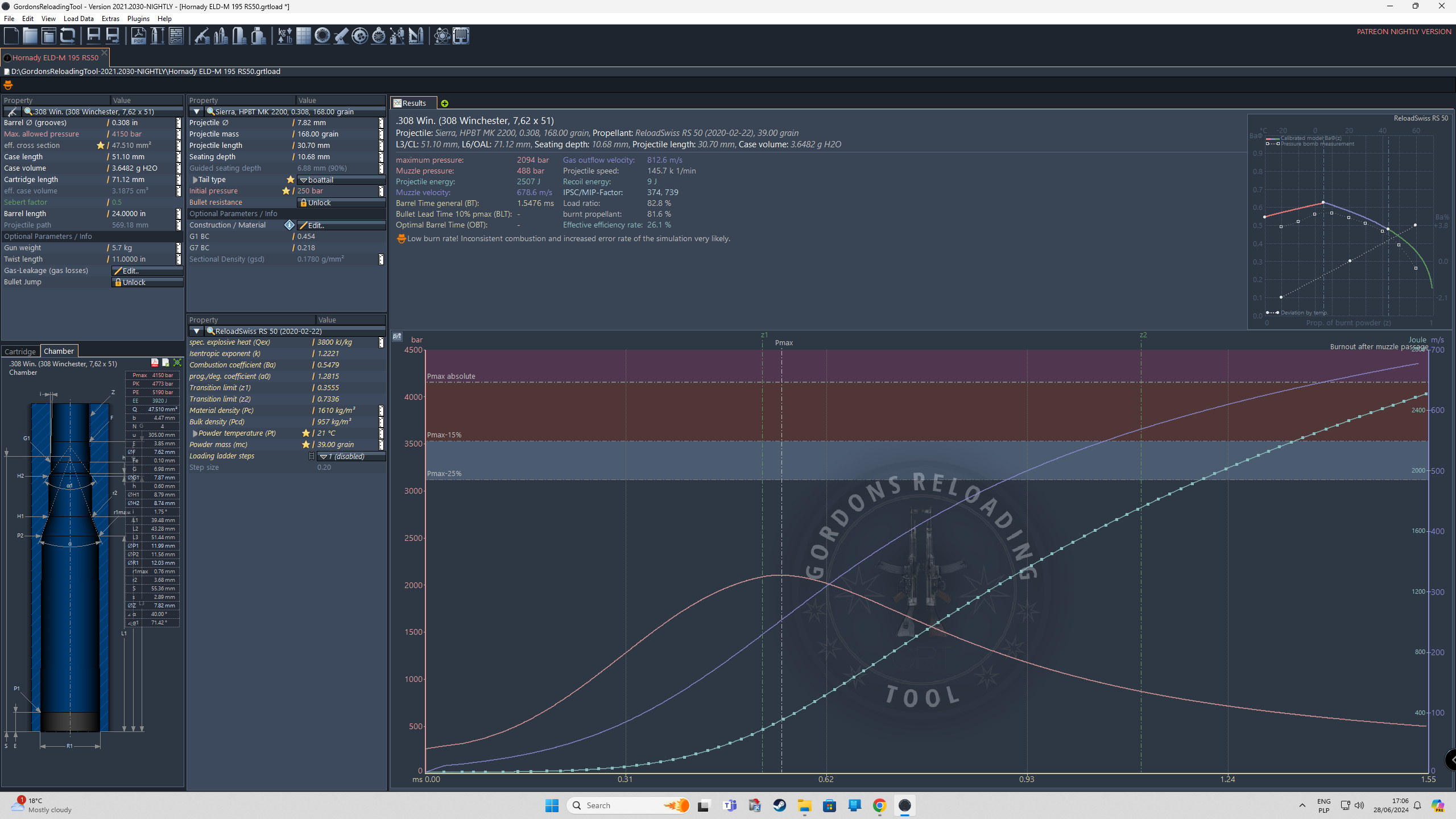

Wonder if anybody using GRT https://www.grtools.de/doku.php what your thoughts about it? I mean how reliable is it ?

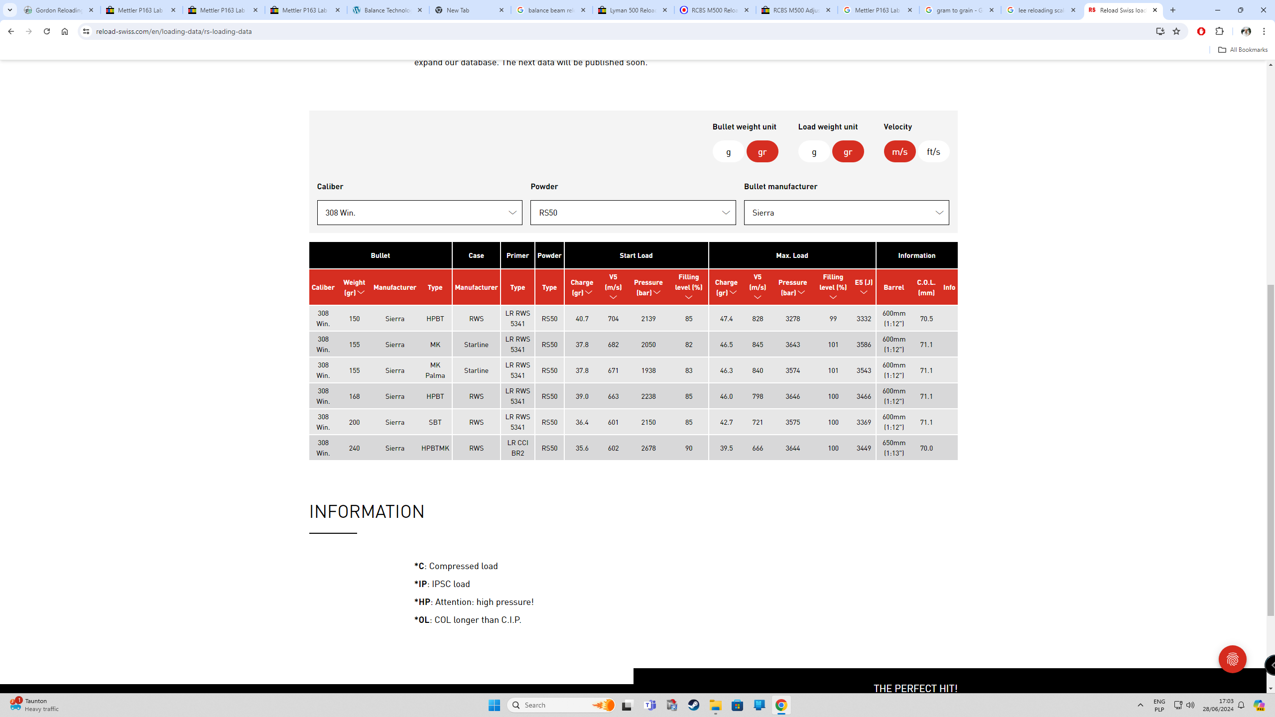

I always checking with manufacturer data. I've just compared load data from Reload Swiss website with GRT for RS50 39gr with Sierra 168gr HPBT match king, results are similar. but In GRT I got my barrel details , and standard values for rest of parameters. Would anybody be so kind and compare it with quickload please ?

Even if its only manufacturers specification, what else You can get?
Even If those databases are only manufacturers info its still easier to use it as guidance than look all over websites and try to find anything. Of course You need keep eye on signs of overpressure, check velocity of your loads etc. But at least You got some point to start with.
With new load I always start with very low amount of powder and step up 0.2 gr until get some good results. It's more time and work consuming way, but safer.
