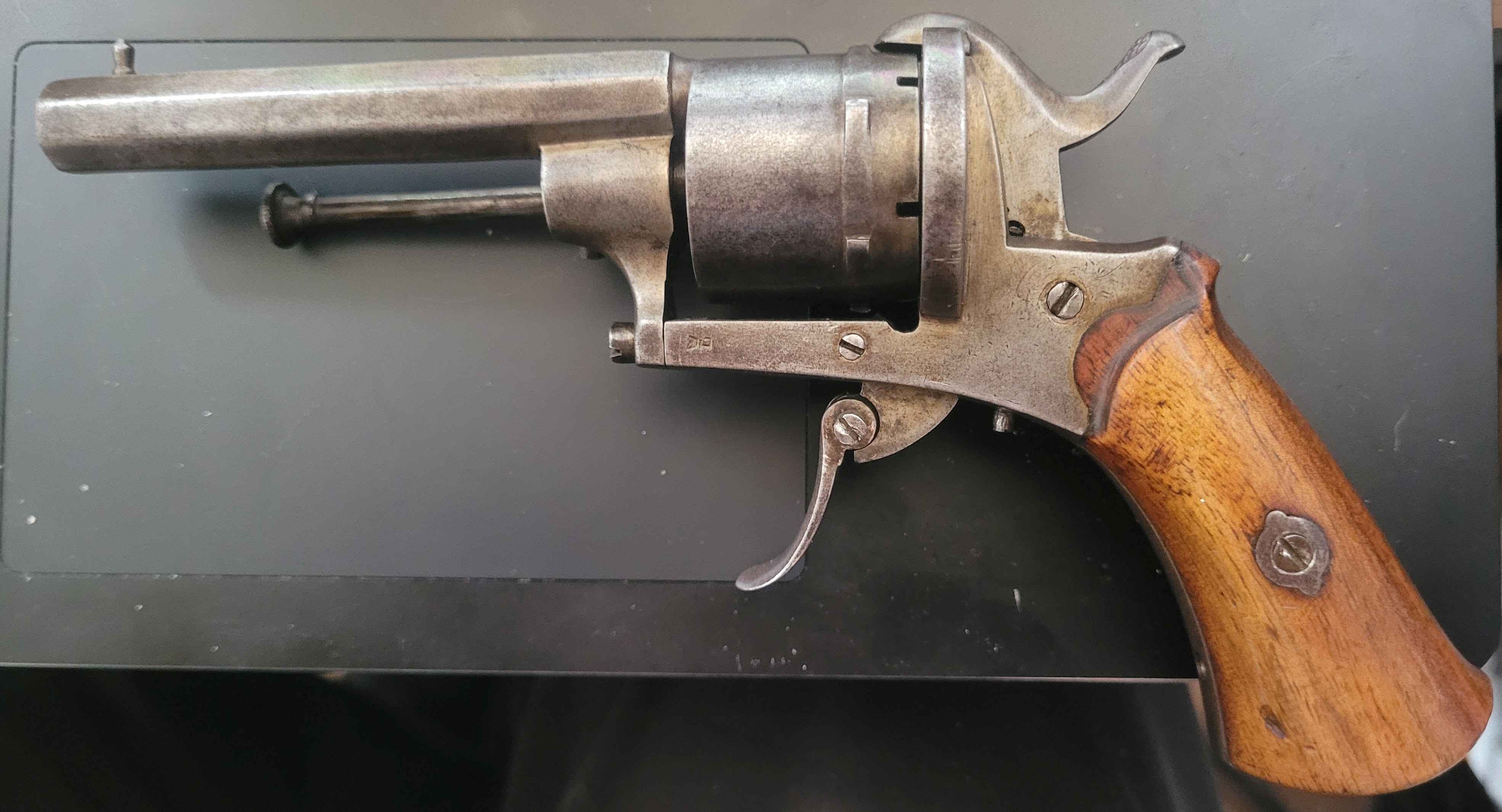

I have just bought a Belgium Pinfire revolver from auction
It looks to be in reasonable condition other than the indexing is out of alignment, I presume this is down to wear, does anyone know if it can be corrected?
From the same number printed on every moving part it looks to be original

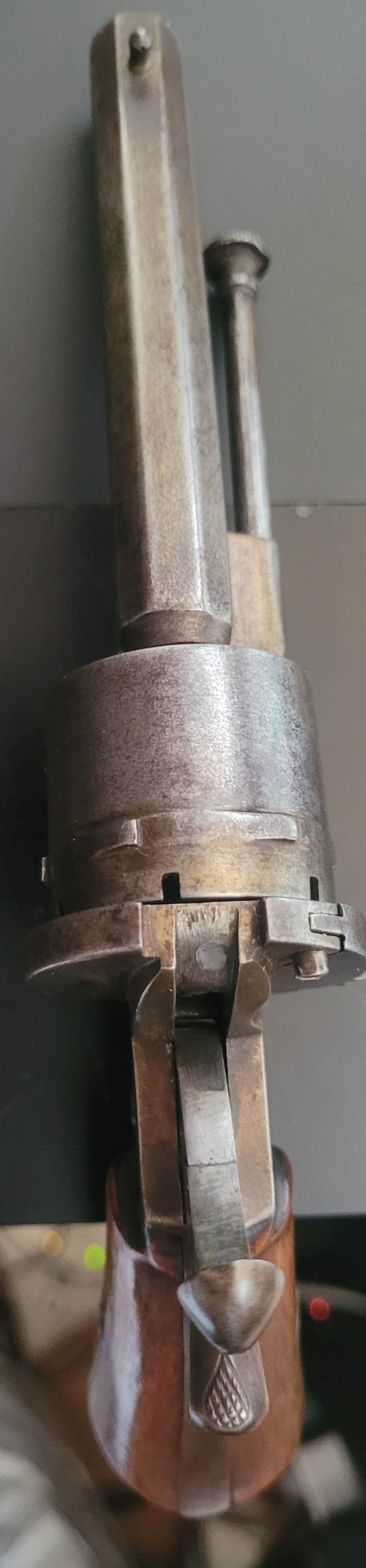

Also, from the stamping on the pin that holds the cylinder, is that a ‘stick man’ or just my imagination?
Thank you
Thank you

Not sure about the 'stick man' - not seen similar. The indexing issue may be either a broken hand or if lucky simply a broken hand spring. These are reasonably easy to disassemble - HLE Books has a pinfire e-book that explains it with pictures.
Good luck with it - these are under-rated in my opinion.

Thank you millemigliadave, I will look out for that book

Re: Belgium Pinfire Revolver
Hi Dave, an interesting couple of hours, but no great success
The strip down was easy enough with no problems, although I couldn’t get the trigger out, obviously it went in, but there must be a knack to it, having three protruding parts and only a slot to get it out, but I could see that nothing would be gained by removing it
I couldn’t see anything wrong with the indexing mechanism, all seemed very good, my conclusion is sympathetic wear on the two necessary parts, it rotates easily enough, but stops before the centre of the hammer, although it did index perfectly with the hammer removed and just using the trigger
Putting it back together took a little longer, getting the springs in place while fitting the screws, all screws now facing the same way (my late father was a carpenter, one of the first things I remember him telling me)
Owning to all the light oiling it does feel a lot firmer and smoother, but that may be my imagination
One thing I have noticed is that the index is still slightly off pulling back the hammer, or squeezing the trigger, but if I squeeze the trigger as fast as I can, it does index correctly most times, but that could be just momentum taking over from the worn parts, pity because I don’t like to fail, but some things are not to be
